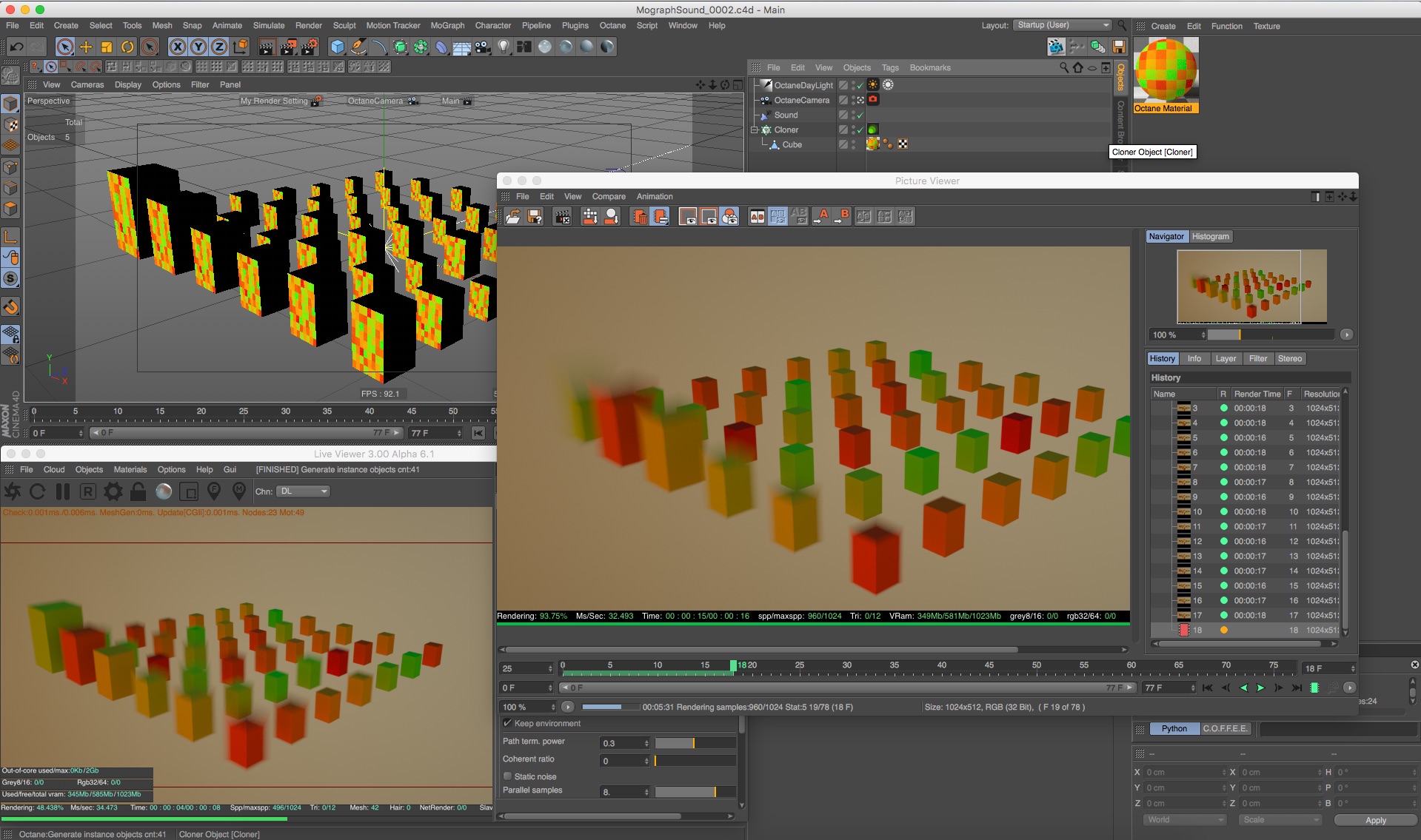

as aoktar already said, it seems that you are not aware on how c4dOctane works in general :roll:
Here is an example of sound effector with motion blur:
MographSoundEffector.zip
(707.66 KiB) Downloaded 568 times
Please, take the time to look at the help/tutorial section:
