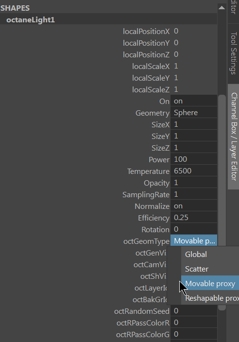

Im really new to octane and just wondering why my lighting isnt being updated in the IPR render view? im using octane lights and i know theyre working because if i refresh the IPR its working fine. kinda annoying having to re-render everytime they move?

Mattielife wrote:Im really new to octane and just wondering why my lighting isnt being updated in the IPR render view? im using octane lights and i know theyre working because if i refresh the IPR its working fine. kinda annoying having to re-render everytime they move?
For any object (even light) to have its transform updated in IPR, set the geometry type to movable proxy.
(For objects animated by deformation use the reshapable proxy geometry type )
