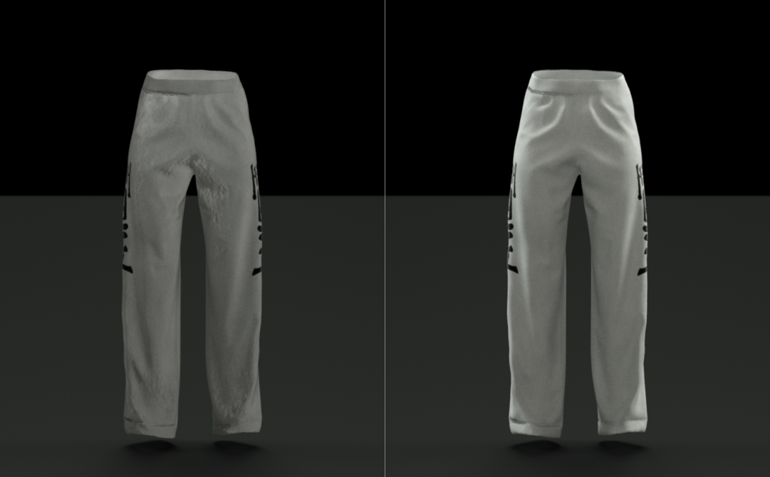

Even tho I didn't notice anything unusual with scattering a few meshes over the ground plane (that one worked fine for me, for now), there's still something very off, in the current OR test build.
My almost none existent 3D knowledge won't let me determine what it really is, but maybe the picture below (or the OCS/ORBIX file) could help.
On the left side is the render from the latest test build.
(I also redid the quick test with the V4 and the custom shader from the earlier and the result looked similar as it did back then.)
Could you send me the ORBX file for this scene pls, and I will take a closer look.

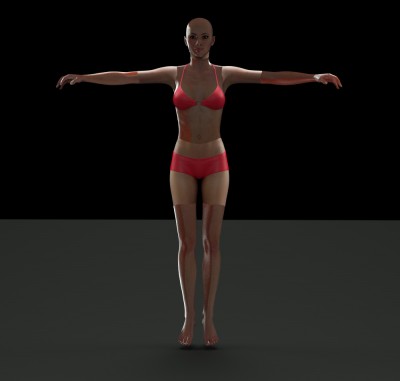

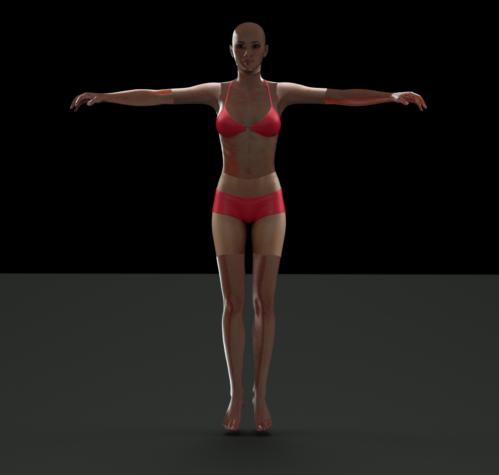

I still have the problem with Redspec materials, they still render incorrectly. I also get regular (not always) CUDA errors: (CUDA error 700 on device 0: an illegal memory access was encountered)

About the custom, or Redspec., materials not rendering correctly. Paul gave me a good idea.
I had, in most of the materials I use, the "Normal" pin set to "Greyscale Color" at a value of 0.0.
Now I have no idea how that happened, as I hardly use Normal maps, but matter of fact is, when actually disconnecting them, the materials are rendering correctly again. As far as I can tell.
Maybe it's worth a try.
Erick
Posts: 249
Joined: Thu Sep 13, 2012 9:40 am
On the neck, upper arms/shoulder, hip and the clothing, the "Normal" pin is disconnected. On the rest, well, not.
