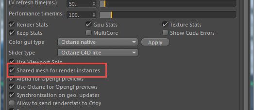

I've got a tiny question though: When I have a render instance of a textured object with layered materials, I usually only shows the second layer on the render instance. Is there a workaround or is it just a limitation?

Don't know a workaround. But i'll look for a fix. You know that's a new feature and still needs improvements or fixes. User feedbacks are important to warn us for mistakes/oversights/etc...

Ok i found why don't work. See image. This fixes the issue. But it's a disabled parameter due potentiel crashes.
