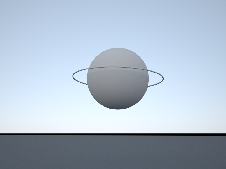

Hi - I'm getting a strange occlusion or dark ghosting effect on a model I'm working on. If I place a torus, or any shape, close to the main tank model sphere it casts a strange shadow and a gradient down the sphere. See pic.

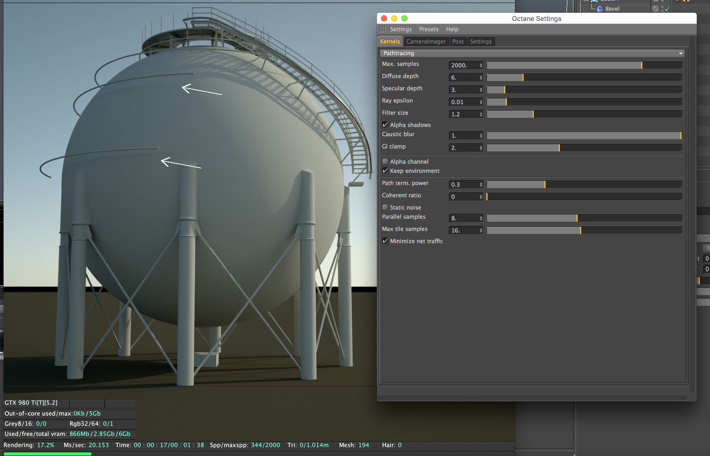

Things I've tried:
1) Increasing sample rate, switching from PT to PMC - in fact playing with all the kernel settings.
2) Alternative HDR environments from low to high resolution - 180 to 360 degrees.
4) Octane Daylight. This works, but it's not suitable for production. I need to use an HDR
Any other ideas? - I'm stumped!
Jason
Posts: 16068
Location: Türkiye
It's occlued area by objects. Nothing is different than as in real world.

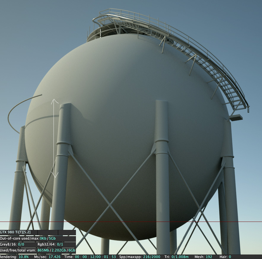

Maybe this image demonstrates my problem better. As you can see, the sun is casting a physically correct shadow onto the sphere but there's also a long gradient being cast on the tank
- this can't be correct surely? My modelling is to real world scale BTW
Posts: 16068
Location: Türkiye
We can check if you put a sample scene. thx

Just a thought.. maybe your ray epsilon value is to calibrate a bit?

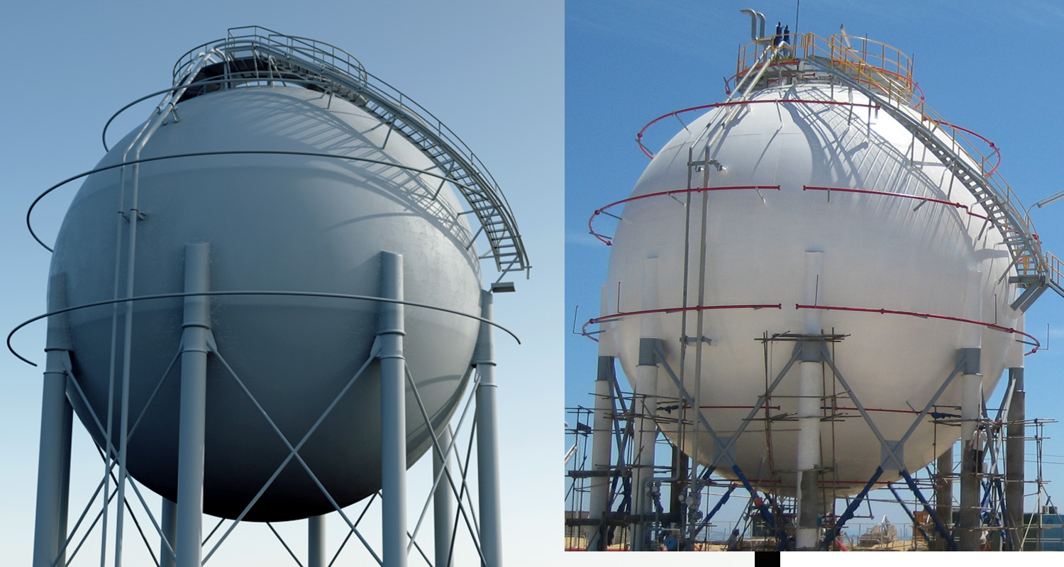

Sorry to return to this again - but now I've progressed the model a little further I'm doubting the gradient effect is naturally occurring again!. So I spent some time searching reference images and none of them demonstrate this effect at all. Here's my model side by side with one of the photos - sun in roughly the same place.
As I said, this happens in VRay too.
Has anyone experienced anything like this before?
