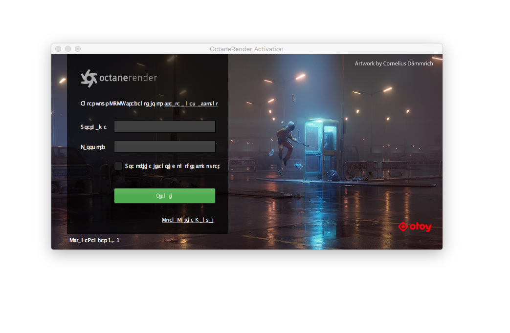

I can't use the plugin.
has anyone seen the license menu glitched like that shown in the attachment?
and possible fixes? i tried reinstall with different versions etc all the same.
It actually offset keys so when you type it enters the key two spaces away!
we figured out the keys to use to make the login details but it still said invalid details.
thanks

Hi djs01,
wow, really weird.
I suspect that is a font issue, could you check your font folder?
If I remember well, the font used should be Lucida Grande :roll:

good idea.
it looks like it's already installed, however fontbook is buggy (crashes etc)
maybe ill look into that, reinstall to defaults etc.
i wouldnt think that it's the culprit though as technically the correct info was used to activate.
ill try though and get back to you.

it fixed the font issue,
but it still says invalid input?
djs01
Posts: 22
Joined: Sat Jun 06, 2015 5:20 am
SOLVED!
1. reset FONTBOOK to default
2. use OTOY login data NOT license data (if on version 3)
