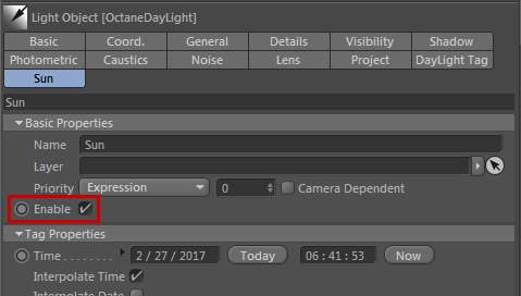

thought its absolutely simple to do.
So I took a octane daylight, make a start keyframe at 15.05.2016
and an end keyframe at 16.05.2016 for example and all is fine, but ....
The time-value in the attribute manager animates, but nothing happens
in LV. Shadow stays quiet.
What I'm missing here?
How could I realize such a timelaps?
thanks
Mike

miohn wrote: Shadow stays quiet.
Mmm... Quiet shadows... I like that!
My guess is that you forgot to enable this.
Regards
Milan

miohn
Posts: 779
Joined: Sun Jun 06, 2010 3:00 pm
Bingo !
thank you very much Milan!
Normally those things are on by default, so I did
not check the basis-tab
regards
