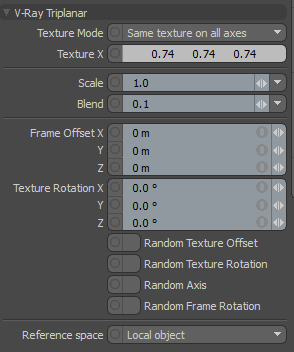

I was wondering if you would consider an additional "simplified" triplanar texture. Right now you need to set up 3/6 image nodes with the correct projection, then plug those into the triplanar node. If I have a folder full of textures I want to quickly try out on my mesh, I have to click the load button on 3/6 different rgb image nodes and browse for the image 3/6 times.
I basically need box mapping, with blending to remove the seams. Maybe it could be a new projection type for images too?
In v-ray the triplanar texture is much easier to use. I just plug 1 texture in, and the triplanar controls everything else (scale, blend, offset, rotation). If I want more control, it also allows separate textures as an option.
The attachment vray_modo_triplanar.PNG is no longer available

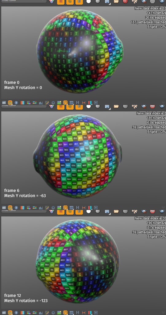

I have been playing around with the triplanar texture a little more. I think the way it is implemented is going to cause problems for animated meshes.
1. This example uses a triplanar texture to do a manual box mapping, but with the seams blended out.
When you rotate the mesh, the textures "swim" through the mesh surface. I have made the X projection darker so its obvious that it always stays on 1 side of the mesh.
ORBX:
octane_306_rot_mesh_triplanar.orbx
(2.64 MiB) Downloaded 275 times
2. This second ORBX uses standard box mapping projection.
When the mesh is rotated, you can see the image map "sticks" to the surface and rotates along with the object correctly.
Nothing looks unusual. No screenshot is included because its hard to tell since I cant darken one side. You can see it clearly scrubbing the timeline in the ORBX file though.

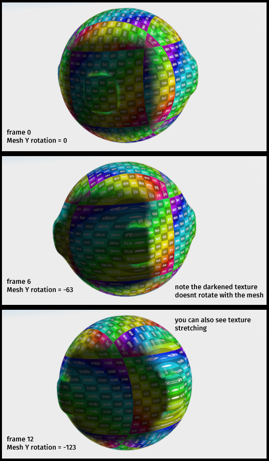

I would like to see an additional simplified version of the triplanar texture that works just like box mapping, but with a blend angle parameter (similar to how V-ray does it below)
ORBX:
octane_306_rot_mesh_box_mapping.orbx
(2.63 MiB) Downloaded 270 times
3. The last example is from V-Ray's triplanar texture
You can see the darkened side rotates along with the mesh
In V-Ray, the triplanar texture sticks to the surface just like box mapping. Notice it also has a "reference space" option.

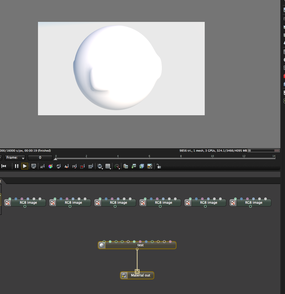

Can some one explain how to setup and use this new texture mapping? I downloaded funk's file but I can not find any specific way of connecting the six textures in the sample file. And the object in the scene just appears white.

pegot wrote:Can some one explain how to setup and use this new texture mapping? I downloaded funk's file but I can not find any specific way of connecting the six textures in the sample file. And the object in the scene just appears white.
You need to load them in octane 3.06. Previous versions will not work. If you are not seeing a "triplanar" node, then you are on the wrong version

Yes I do have 3.06 test version - even had to update CUDA for it. And I seem to have all the other great new features. But I can't find the triplaner nodes. And the below screen shot is what it looks like for me when I open your file:
I'm on a Mac, by the way.

pegot wrote:Yes I do have 3.06 test version - even had to update CUDA for it. And I seem to have all the other great new features. But I can't find the triplaner nodes. And the below screen shot is what it looks like for me when I open your file:
Add a triplanar (texture/mapping/triplanar) texture and connect it to the diffuse node of the material. The triplanar node will provide six material node, just connect each of them to the textures.
Edit : You may use the blend angle to control the blend between each texture.
