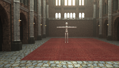

Here's the scene I'm rendering:
Castle Scene
Castle Scene

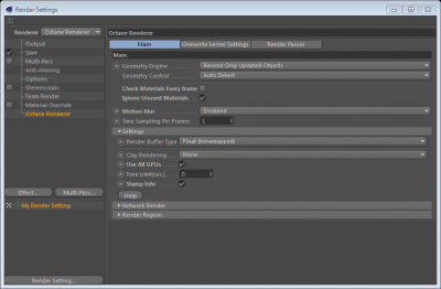

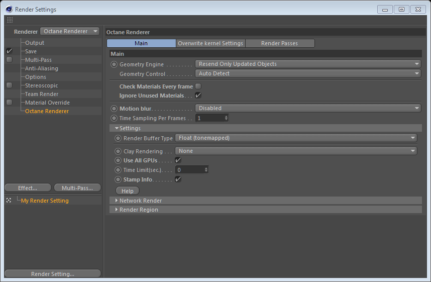

Here are my PV render settings:
Render Settings
