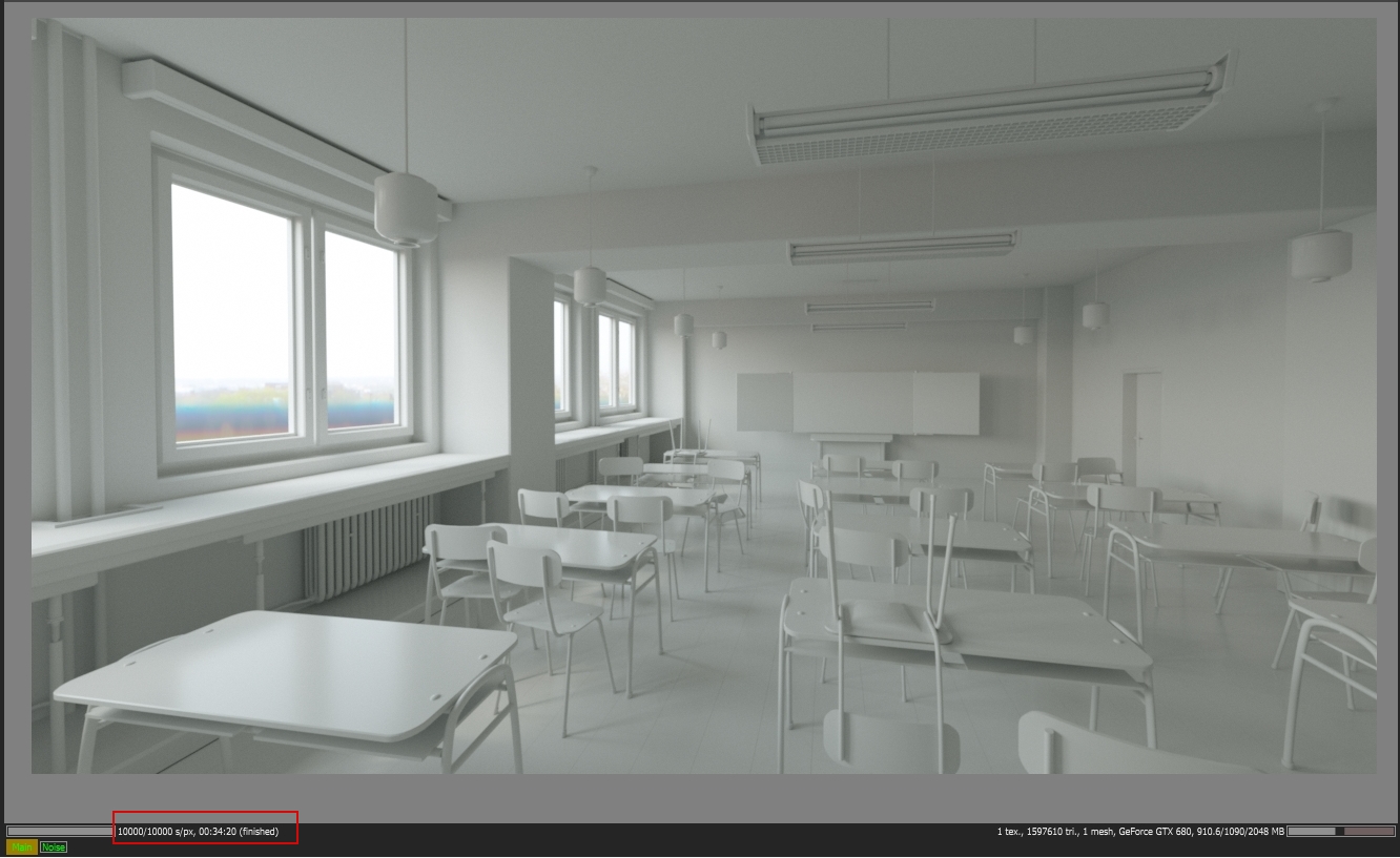

thanks Otoy guys! it's a breakthrough!!! adaptive sampling very comfortable, great feature! now there is a confidence that the rendering will stop when I need to.) I will test further with the materials.
with adaptive sampling
without adaptive sampling
time difference twice! and I can make it even faster!! :o

That's ^^^ awesome!
The no AS one wasn't even noise free at double time!

prehabitat wrote:That's ^^^ awesome!
The No AS render has only been rendering for about 2 minutes though.
I think we should be comparing images that have cooked for the same amount of time.
