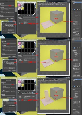

two direct light at extremely low altitudes from the floor

Hi Goldis,
why are you so angry, what if you were to work with inches?..
If you will have to work on a ship 3D model, produced in the US, do you ask to developer to edit it in mm?
I have repeated a thousand times you can work with mm cm m km, this has no effect with unit set in mt.
I do not understand what the problem is. Is it so hard to accept Octane think in meters? It sounds something like absolute and relative coordinates, where is the problem so angry?
About ray epsilon, I do not consider to be a relationship between absolute ray epsilon and unit scale, its use is subject rather the scene you're rendering, geometry, and distance from the camera. However, in this specific case you are ignoring GI.

paride4331
Posts: 4004
Goldis, That may not have come out the way I intended.
I said you can work in any unit of measure you want.
I did not say you have to work in meters.
I simply said Octane engine thinks in meters.
No matter whether you work in mm cm or meters with 3dsMax.
But when using parameters such as z-depth, diplacement etc and/or kernel values they are in meters.
Then "1" is not 1cm or 1mm but 1mt.
Regards
Paride
