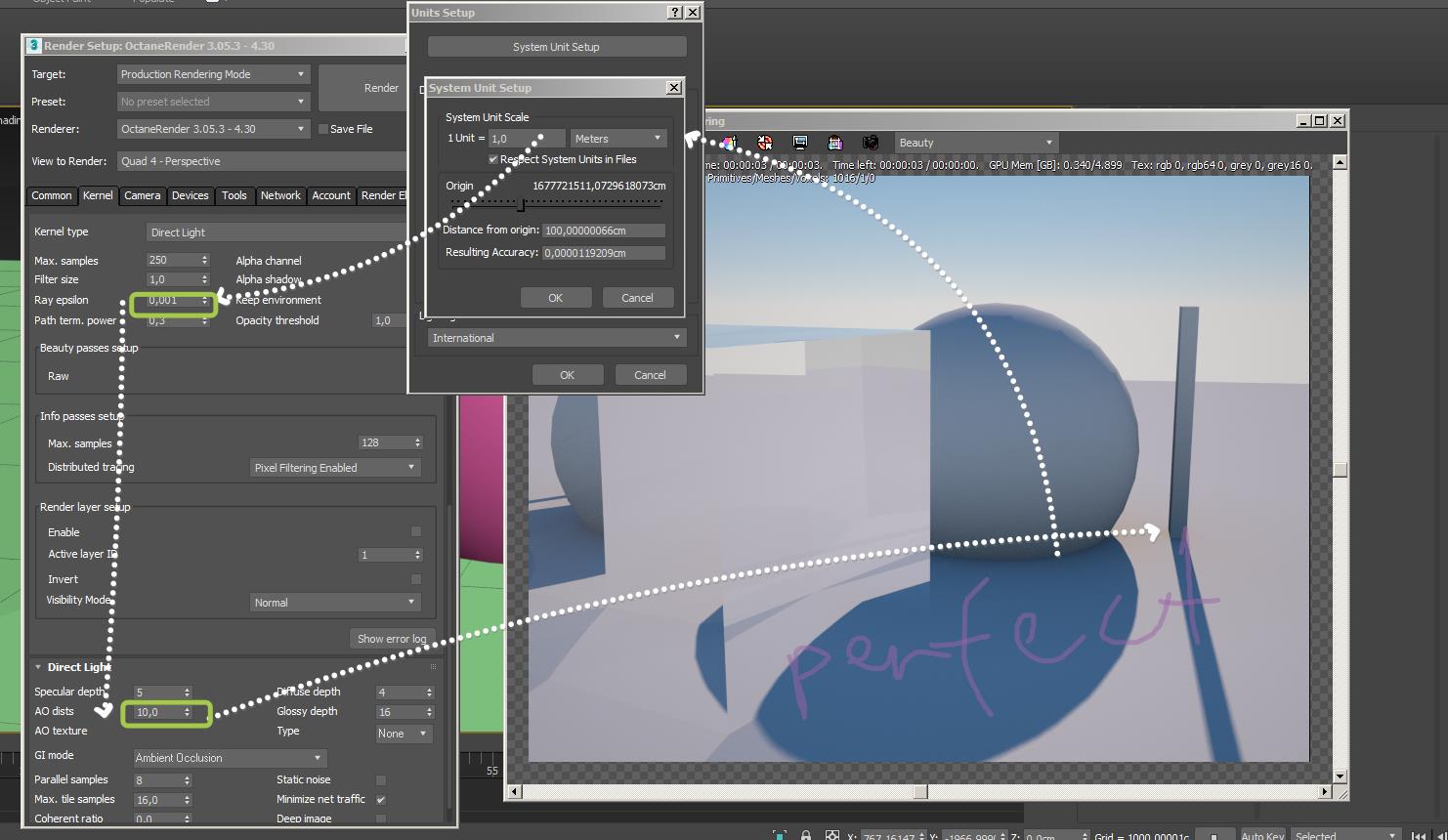

Goldisart
Posts: 780
Joined: Sat Oct 26, 2013 8:47 am
HOW long do I have to prove to you in reverence and bows that the conversion should be automatic ... none of the regular users will not consider such trifles as the render will be an ASS
1.
2.
3.
Goldisart
Posts: 780
your all library material will not work in different worlds all settings of density of materials - ass ... all the settings fog smoke - all need to be reconfigured
dispersion - the level of density of the color glass - the level of displays etc.... ass ass ass
you foam at the mouth to prove that we must work in the meter world - but we will never work - IT's UNCOMFORTABLE - and all your settings optimized for the m WORLD !!!!!
