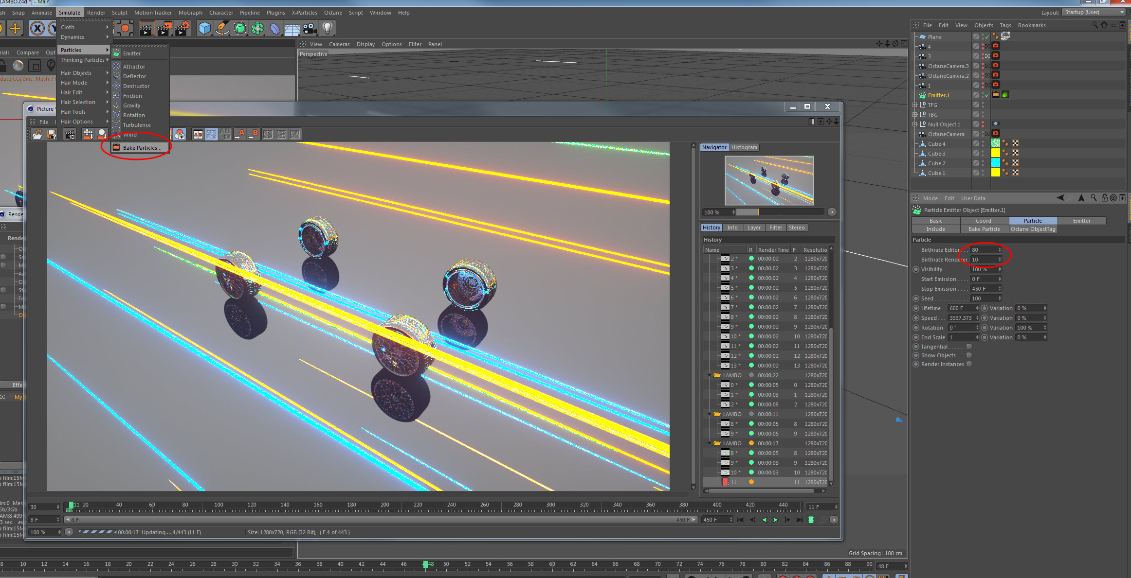

I am using the standard C4d Emitter to emit streaks with texture emission.
it renders ok in the live viewer, but in the picture viewer either I have no particles at all or only a small amount.
Is the first time that I attempt to use particles with octane, so I am a noob at it.
All help would be appreciated as I have a deadline this week :(
thanks in advance.
Scene file attached
LAMBO.rar
(6.6 MiB) Downloaded 205 times
Posts: 16068
Location: Türkiye
See image! You need to bake the particles and be sure same counts for Editor vs. Render

AOKTAR!!!
THANKS A LOT! you saved my life :D
