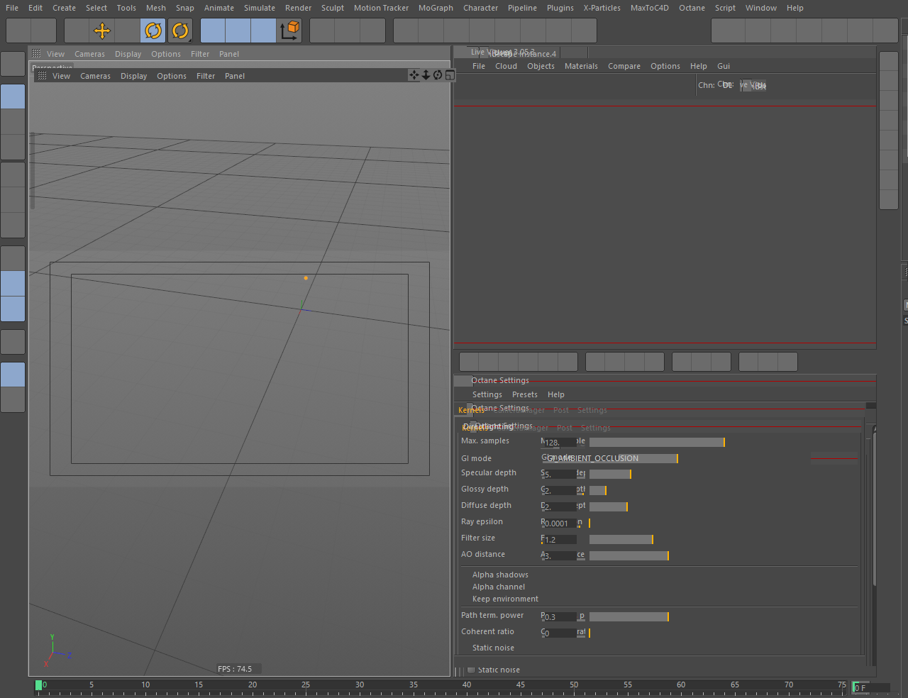

H. Happens on any scenes I have worked during the day 3-4 times. All icons disappers. Within few seconds I can even save scene. Then cinema 4d stops responding. Most time I work on huge scene. But this happens also on simple scenes when I make some tests.
I. Bug report included.

I don't think that's a bug for plugin. Have you ever checked VRAM usages while working? Looks like a problem in driver or so propably due free VRAM amounts.

It never happened this way in post versions. After last plugin update it started.
But I will check VRAM usage again anyway. As I said it happens on simple scenes aswell. Do you need some other info or scene involved ?

Did you removed unnecessary plugin versions after install?

aoktar wrote:Did you removed unnecessary plugin versions after install?
I fully reinstalled standalone and plugin.
