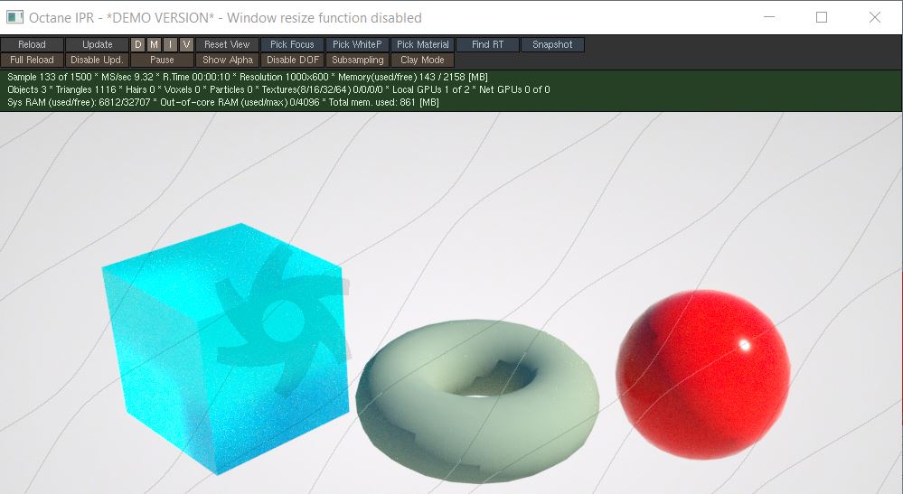

Just testing out the demo. I have two GPUs, one for monitor (that I want to disable as the vram is only 3) and a 1080.
Looking at the Plugin Options, it doesn't indicate which one you are enabling?
Even the IPR window doesn't show the type/version (1080) as the standalone does.
I've also tried to enable both and reload/update and it continues to say Local GPU 1 of 2 in the IPR window.
Can someone tell me what I'm missing?
juanjgon
Posts: 8867
Location: Spain
What demo version are you using? In the latest versions, the GPU type is printed in the GPUs options panel tab.

I got this octane log on my desktop though.
og started Thu Feb 9 17:28:17 2017
Octane Render for Houidini by Juanjo Gonzalez. Build 3.00.20.1 (Build date: May 31 2016 11:13:18)
Octane API: 3.00
HDK API: 15.5.480
Houdini host version: 15.5.717
System: GenuineIntel Intel(R) Core(TM) i7-4930K CPU @ 3.40GHz, 3348 Mhz., 12 cores
OS: Windows 8 64-bit
