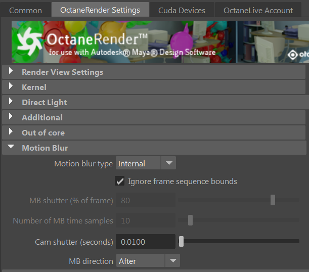

1) How to show Motion blur?
There is a Motion Blur Type under the render settings, which is set to 'None' by default, but I tried both 'Subframe' and 'Internal', and messing around with the parameters doesn't seem to do anything.
