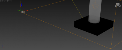

Hello i have a little probleme when i export my vdb from fumefx and import to vdb octane , i need to move the little cube all around my scene ...,and its a pain in the ass , have you a quick tips for doing it fast and precise

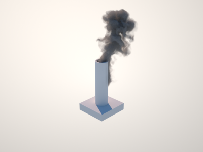

i found a sollution to it.
you have to allign the Octane Vollume Object with the Fume Grid on the Y Axis. and also roughly match the Dimensions of the Vollume Object with the Dimensions of the Fume Voxel Grid.
Using Octane 4.25 here btw
