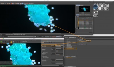

Solution, use the c4d sub frame motion blur by dividing the total sampling by the number of passes, in this way the final render time will be almost equal.

Can you please explain this more detailed "Use the c4d sub frame motion blur by dividing the total sampling by the number of passes, in this way the final render time will be almost equal."
Didn't managed to make it work. Thank you!

Thank you very much for the example. I'll do some tests right away.
