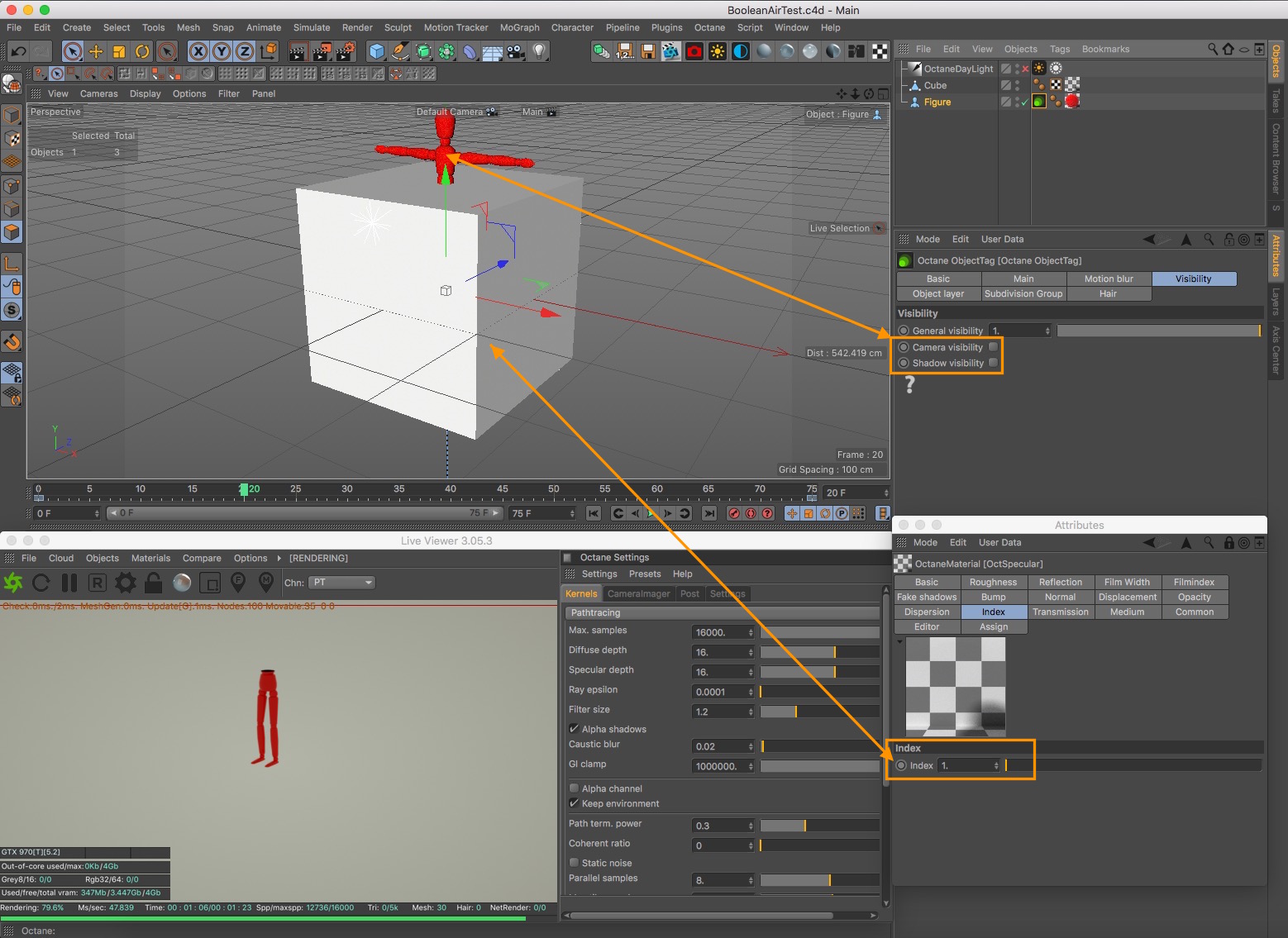

Hi Oxidizer,
interesting request :)
look at this trick about boolean air:
BooleanAirTest.c4d.zip
(84.34 KiB) Downloaded 197 times
ciao beppe
