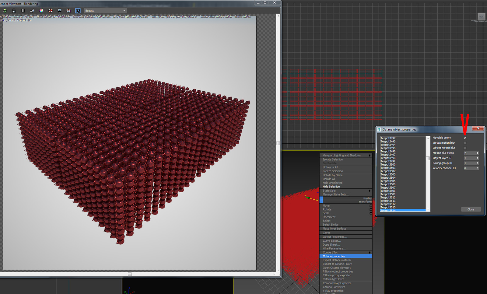

I downloaded Max plugin and did a heavy test scene with a lot of teapots(instances). When I try to do a test render I see black screen with "processing geometry" or something like this longer than regular Mental ray does the whole render with enough quality. Is it normal? I have kind of similar problem with Blender plugin where the render is not same interactive as Cycles when does a complex scene.
I wonder am I missing something? Some hidden settings?

Hi Kirk,
you have to use the movable proxy command, as in the screenshot, after making istance.
Regards
