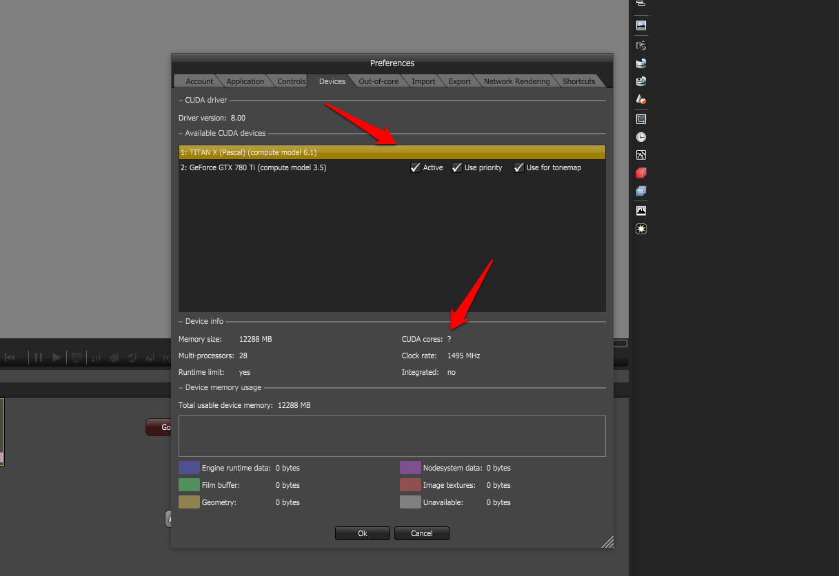

Hi all, I just installed my new Titan and sadly it seems to be rendering nothing???? Currently my system has a Titan X and a gtx 780 Ti and octane sees the card but is not utilizing it? I updated my drivers upon install so I have no idea what is happening? Maybe the titan x is not compatible with octane? Picture attached.

Which version of Octane you are using ?
For Pascal GPU support you need Octane 3.0x

Hi Lewis thank you for the response. I am running octane 3.02 standalone. Is this not sufficient for pascal?

Mugz wrote:Hi Lewis thank you for the response. I am running octane 3.02 standalone. Is this not sufficient for pascal?
Try newer (3.05.3 is latest i think) just to be sure. I don't remeber exactly which version enabled Pascal support but it was not initially at 3.0 but later at 3.0x something.

Ok, I'll give that one a try and report back. THANKS.
