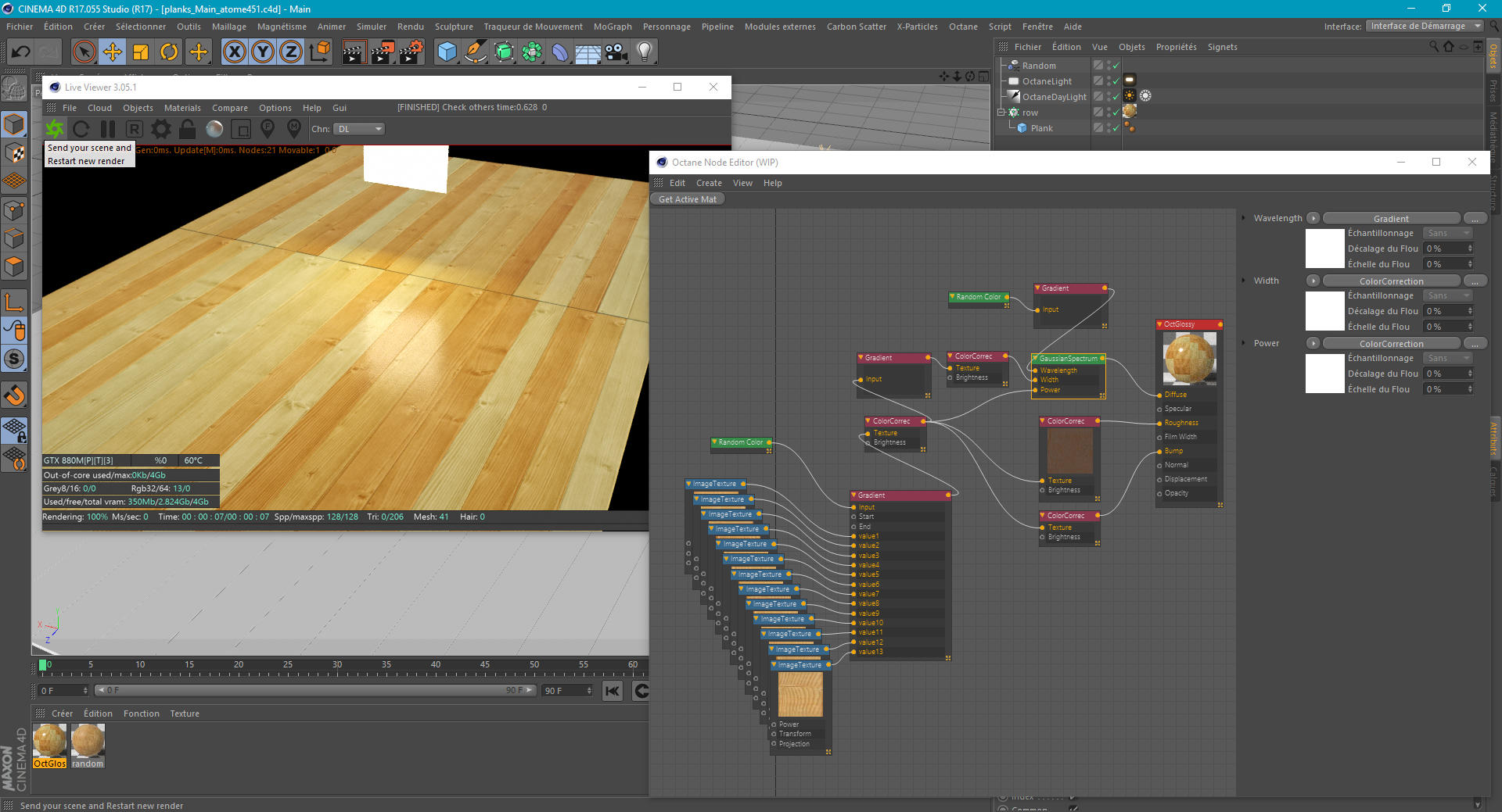

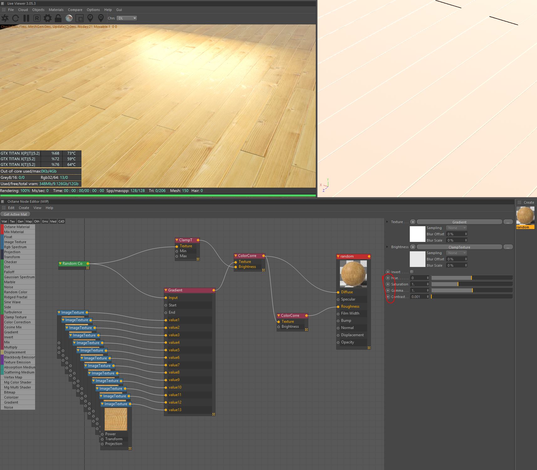

Hi all,
It's possible to do that with GaussianSpectrum. It's a little bit tricky but it works... ;)
There is ports for the Color Correction node in the Standalone (Hue, Saturation,...) but they only accept various constant Float values (NOT "mapped" FloatTexture values). Right now it's not in the hands of Aoktar.
There is no useable ports for random colors in the Transform or Projection nodes in the Standalone too. Then Aoktar can't create nodes that doesn't exist in the Octane SDK. But indeed it could be very usefull to be able to randomize UVs transformations in instances.
Here my little and fast done sample. It's only one solution, there is another ways to do that but GaussianSpectrum is a good starting point:
planks_atome451.zip
(491.63 KiB) Downloaded 172 times

Node editor is highly based on Octane nodes. But it's not anything more than working from mat manager. It's just a wrapper for your material editing. No extra storage not a xpresso. Just another shape of mat manager with extra capabilities.
Anyway it's possible to work with any parameter linkings. As i said it's just a monitor to node connections. Just will not display else of materials/textures like connections to another type parameters. But they will work and editable from another editors.
