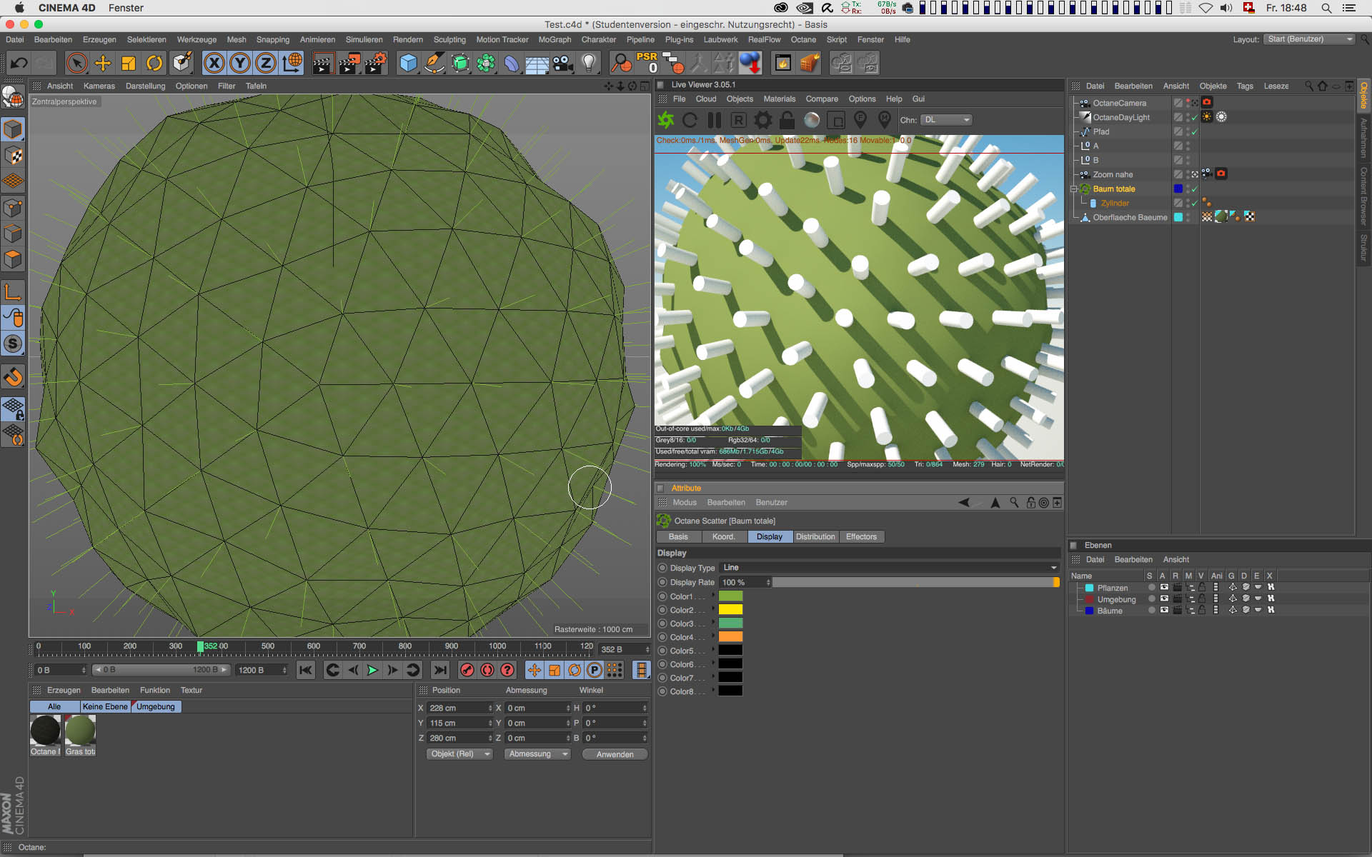

the camera angle changes a lot, when I enable motion blur. Img 1: unchecked, img 2: checked. I found out, that it seems to be related with the motion camera tag, but didn't found a solution.
Also, if you change scatter object display from line to object, scattered object seem to be displaced (img 3 & 4).

It seems like a overlook on some parameters in motion tag. It will be fixed on next release. Your other words dont make any sense on me. There's not any functionality to modify the vertexes of distribution objects.David_S wrote:Hi,
Motion Blur on moving objects with a fixed camera works for me without a problem. I just used it yesterday.aoktar wrote:It seems like a overlook on some parameters in motion tag. It will be fixed on next release. Your other words dont make any sense on me. There's not any functionality to modify the vertexes of distribution objects.
About the scatter: You can see that the distribution of the objects is different in the two previews.
Thanulee, maybe you could render the tree with lines or without smoothing, so we can see which distribution is the one rendered?
