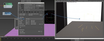

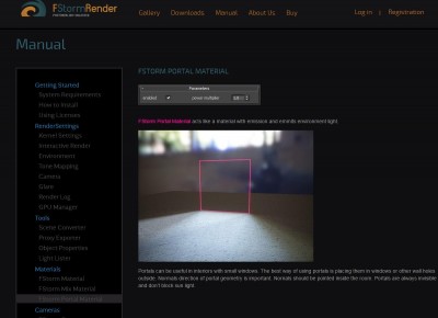

I could be wrong but I think it needs something like this to work ? still don't understand

Hi Goldisart,
portal material, does not work as in fstorm, vray etc.
His name could cause confusion.
This material is used to "indicate" where to go out to the light.
This is to prevent looped light rays that may generate noise.
https://docs.otoy.com/manuals/products/ ... g-portals/
Regards
Paride

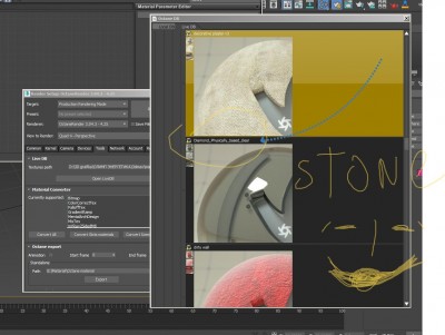

I noticed during material conversion that Roughtness always converts to 0,0 no matter how it was set in Vray?
Is it only me?

Hi mbetke,
I'm testing the conversion of V-Ray materials in glossy material; by next week I should send my test developers.
This is a test about roughness and looks good; I encountered some issue with IOR and RGB but not with Rglossiness.
I would be very interested in your issue, could you kindly share two files with your V-Ray material and Octane converted material?
Regards
Paride
