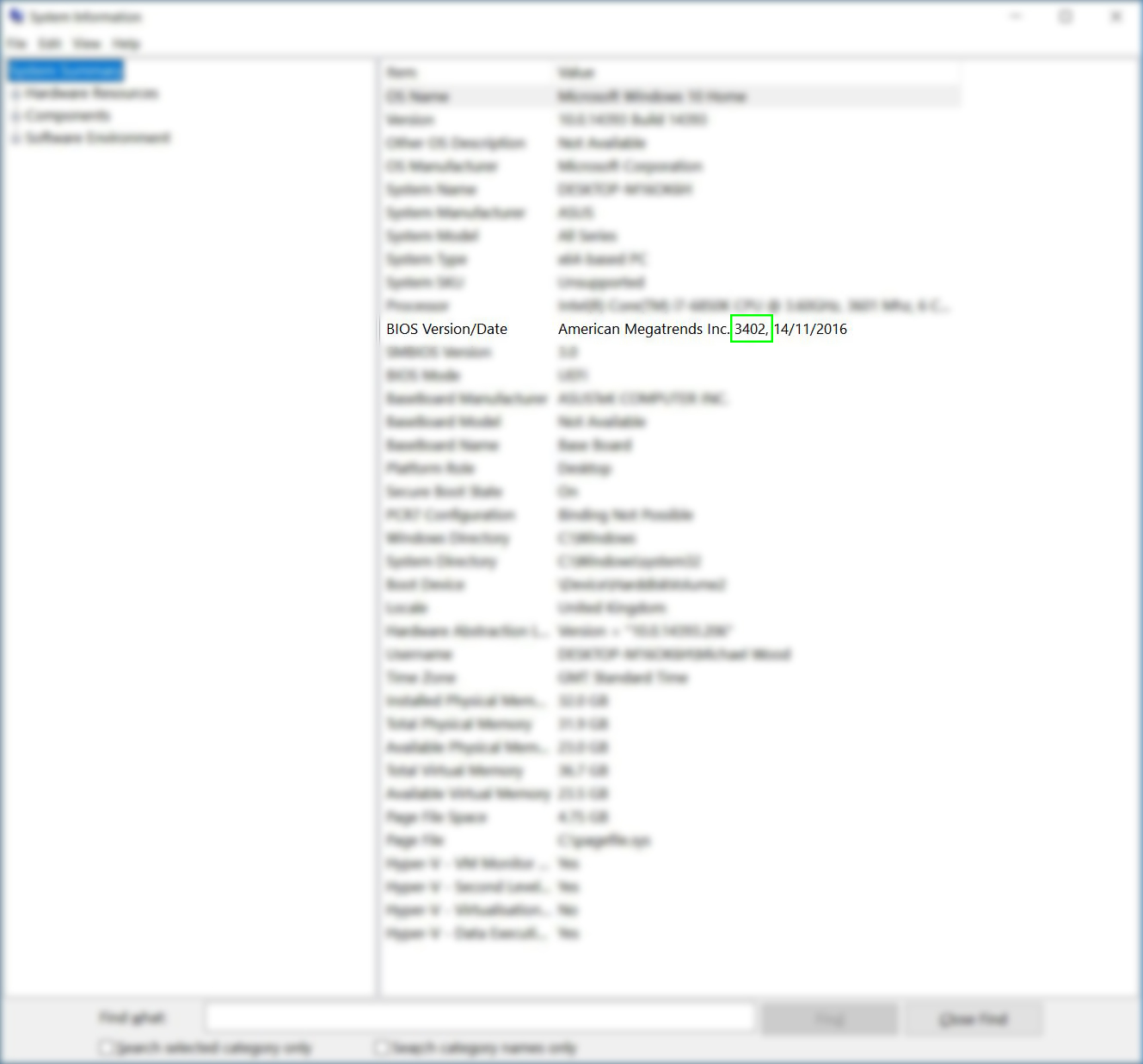

First step was to update the BIOS after advice from Smicha, I'm not sure if this helped in the long run but it may of contributed. Now this may depend on manufacturer but mine is an ASUS X99-e so I updated to latest BIOS version which was 3402 at time of writing.
You can find this information by going to system information in Windows then cross compare with manufacturer driver/BIOS versions to see which one your on.
In my case (https://www.asus.com/uk/Motherboards/X9 ... _Download/) Pick OS > Drivers > BIOS

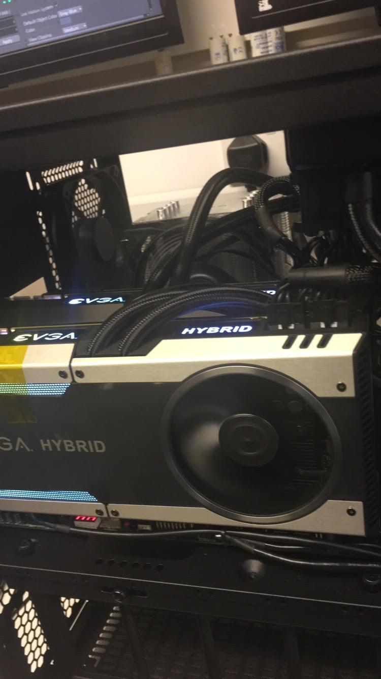

I then cleared all my Nvidia drivers AND Octane plugin and Octane Standalone then proceeded to shut down my machine. I then removed ALL my cards, just to note I have a 980ti for display and 2x 1080 Hybrids. I then put the 980ti in and booted up machine to see if this card worked....Installed necessary drivers and also installed Octane Standalone Version 3.05.1 and Octane C4D 3.05.1
I rendered and everything was fine, but my intention was not to use 980ti as render card so no extensive test was made. I then shutdown and put one of the 1080's in to test it alone. I tried with the latest Nvidia drivers but got a crash/CUDA error with one of the 1080's ALONE...I was only doing 20 minute benchmark renders so this couldn't really be enough evidence to prove much...But I was definitely getting more than I had been. So 20 minute on each card, one failed and one didn't which was strange.
I made sure to label each card with a sticker while I was doing these tests...
So once GPU's tested to see if there was a hardware issue. I determined that one of the GPU's could be faulty as every time this 1080 was in it would error, but other one wouldn't. So that is going back to manufacturer and a 1070 is in its place for the time being till replacement.
