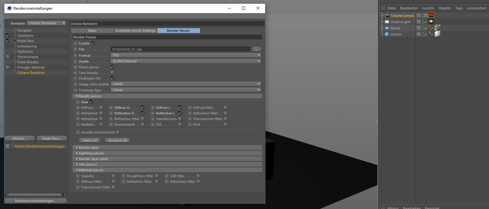

Hey,
i want to get 32bit floating renders to adjust in post the brightness and to have all information stored in the picture.
Are these settings correct?
And do i have to tick on "Raw" in the "beauty passes" setting?
Or what does "Raw" effect=
Thanks for your help community :)
Posts: 10469

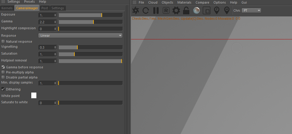

Hi Chillkroete,
everything seems correct, maybe you can zero out also the vignetting value, and add it in post if needed.
With Raw option enabled, you have to multiply the raw pass with it’s matching filter pas:
https://docs.otoy.com/manuals/products/ ... ty-passes/
ciao beppe
