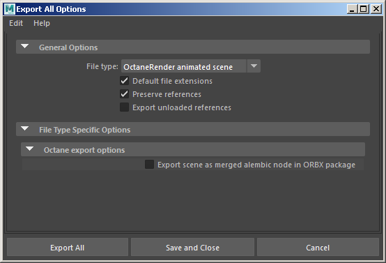

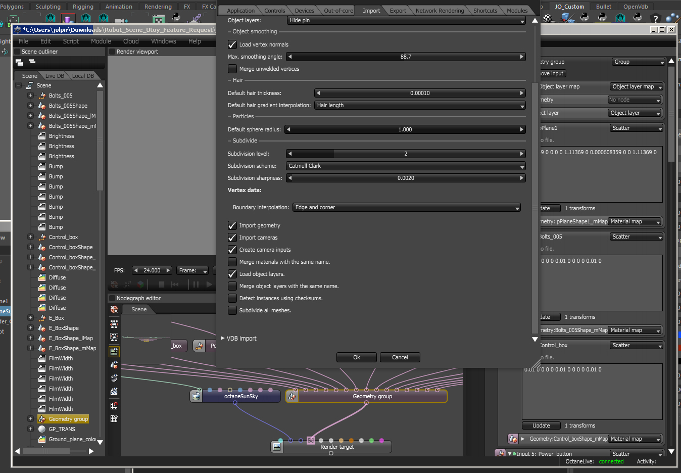

Thanks a lot for the new update all great so far. We have just a requested of one issue for us is kind "essential for our workflow".
Basically if we export the scene from Maya with the option "export scene as merged alembic node in ORBX package" deactivated, we don't have the abc node as before we have something not working in the standalone.
We have the options at the standalone this options are ignored "import cameras", "Create camera inputs" and "load object layers" we had before a abc node with the camera inputs and the object layers options.
Please any advise, I just add some screenshot here.

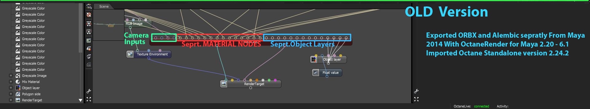

Hi Jim,
As Jo said we need something like this for our production workflow
maya Animated scene export feature request

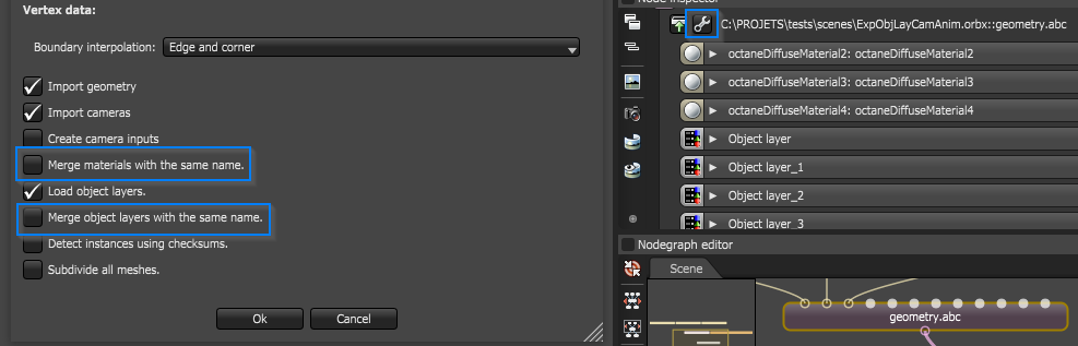

After some tests I found that the actual exporter result is way better for any workflow,
and as I said you last time for your workflow, if you need one pin per shader map and one pin per object you have to disable
"merge material with same name" and " merge object layer with same name" in the import setting of the ABC node:

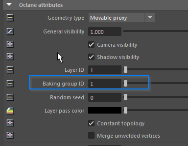

Also if you want to export object layer and get the same object layers in Standalone, you have to set the Bake ID to 1 in Maya for each object you want an object layer for.
(bake ID default to 0 in Maya, but in standalone there's no ID 0, so they are exported as 1 anyway,but if in Maya you change Bake ID from 0 to 1 you activate the exportation of the object layer for this object)

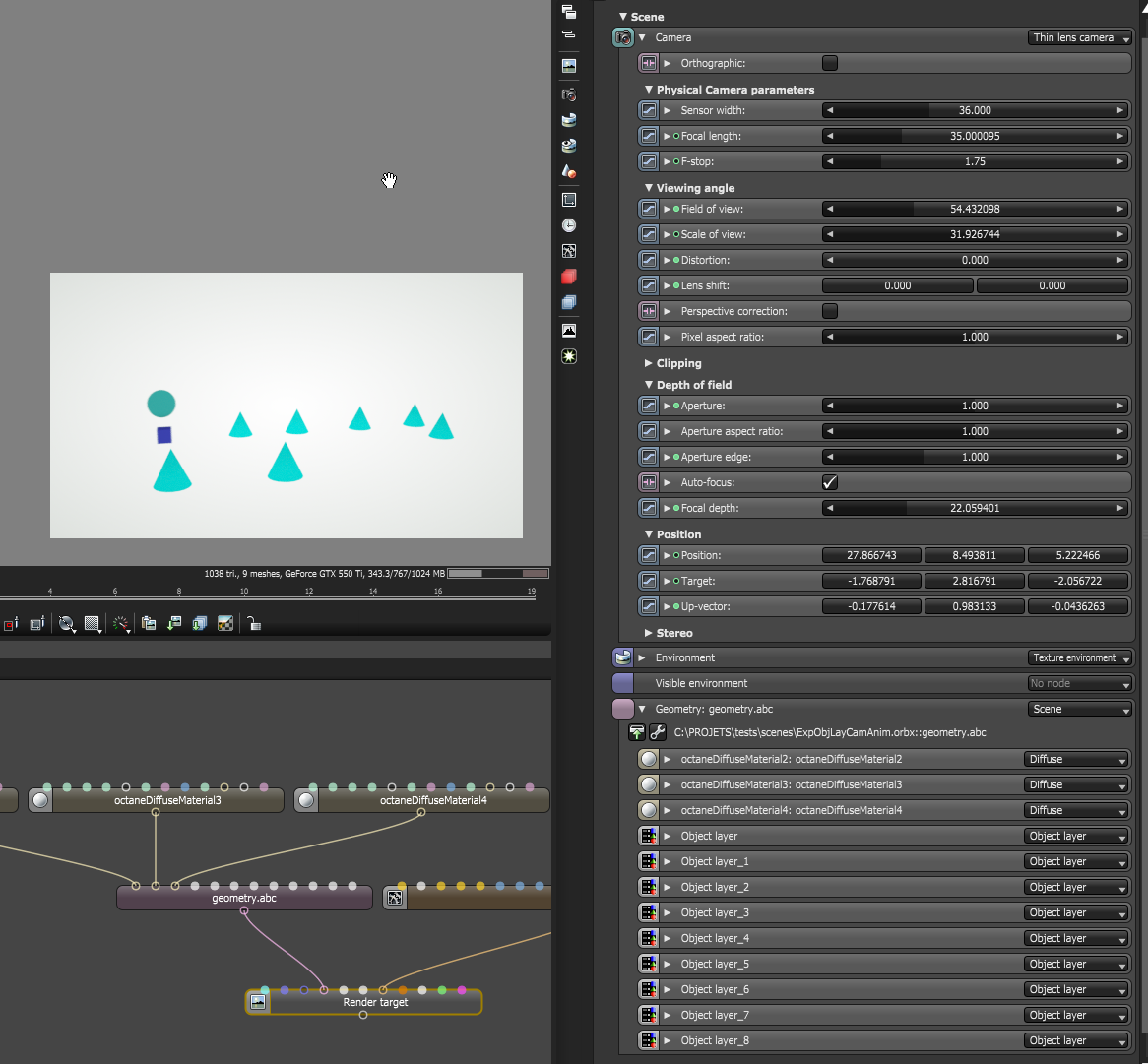

About the camera exported by the last version, it really works now, I mean every animated attributes in Maya are animated in standalone and are accessible,
this is not possible to have all these settings accessible and animated if the camera is in the ABC node.

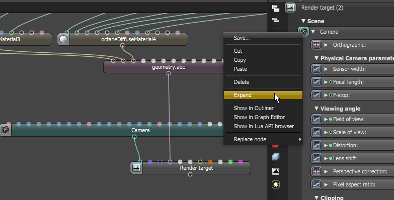

Also I'm not sure you realize you can access to the same camera pin than for the ABC camera, by expanding the CameraNode out of the renderTarget node:
But I agree we should have an option to export the camera as embedded or not in the ABC node.

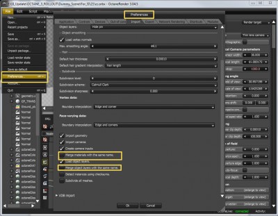

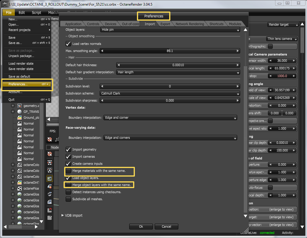

1) Right now .abc node is compact and merge even we click check off merge materials as well as objects with same names from main octane standalone preferences under import alembic settings not sure why opened scene is not obeying preferences options?
preferences Issue
preferences Issue

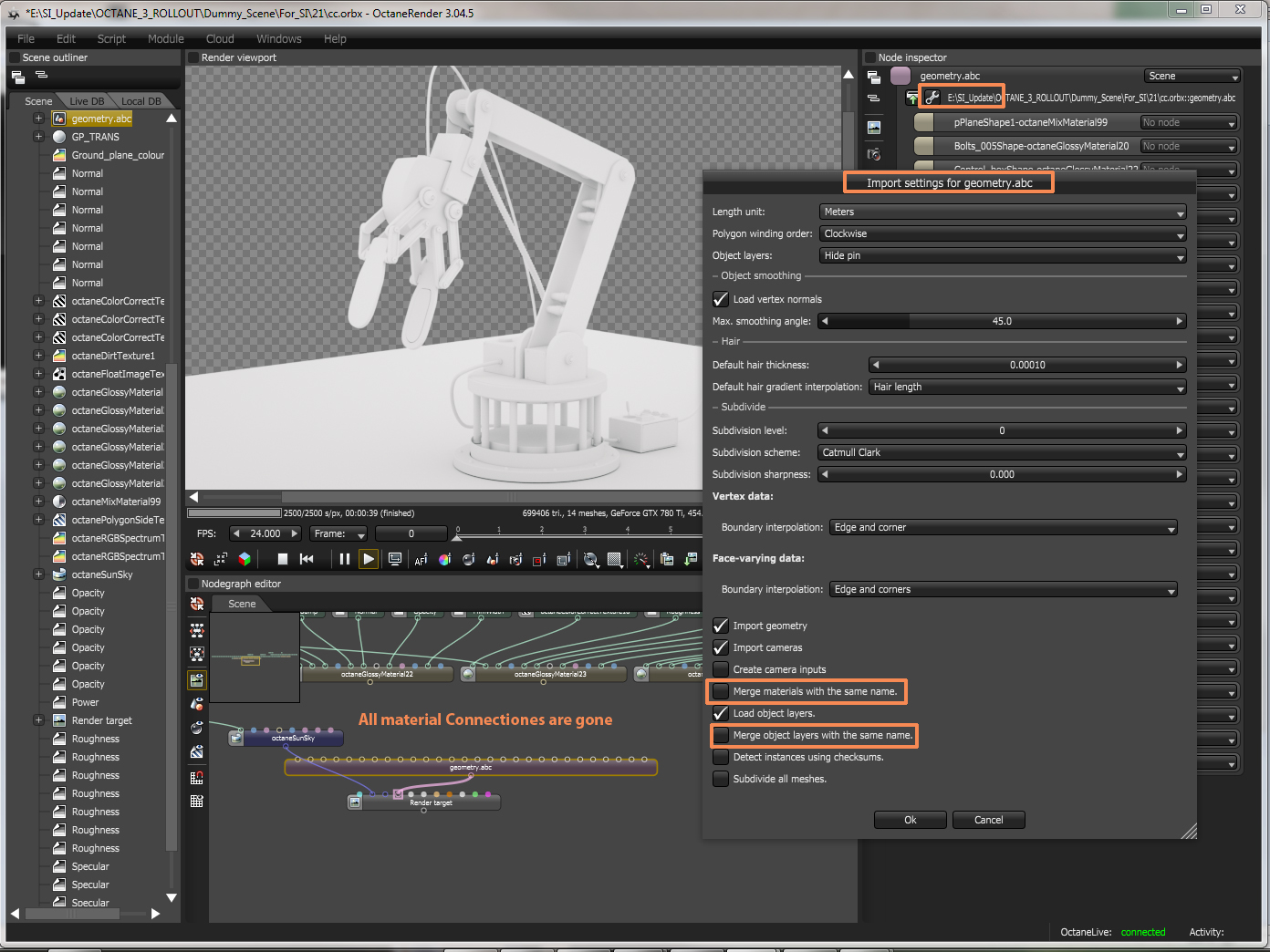

2) To achieve separate input circles material I tried changing Import settings of geometry.abc node it self by clicking check off for merge materials and objects with same name as soon as we did that it all material connection are braked and there nothing connected to geometry.abc node We also loos all the camera options which was there before we cant re connect all the material to each node manually for large scene
material connections
Please help us to find way for this issue.

HMXMedia wrote: 1) Right now .abc node is compact and merge even we click check off merge materials as well as objects with same names from main octane standalone preferences under import alembic settings not sure why opened scene is not obeying preferences options?

Anyway, disabling "merge material with same name" in ABC node import setting, should not loose the connections in the first place,
I consider this is a bug, I will report the bug in Standalone section.
