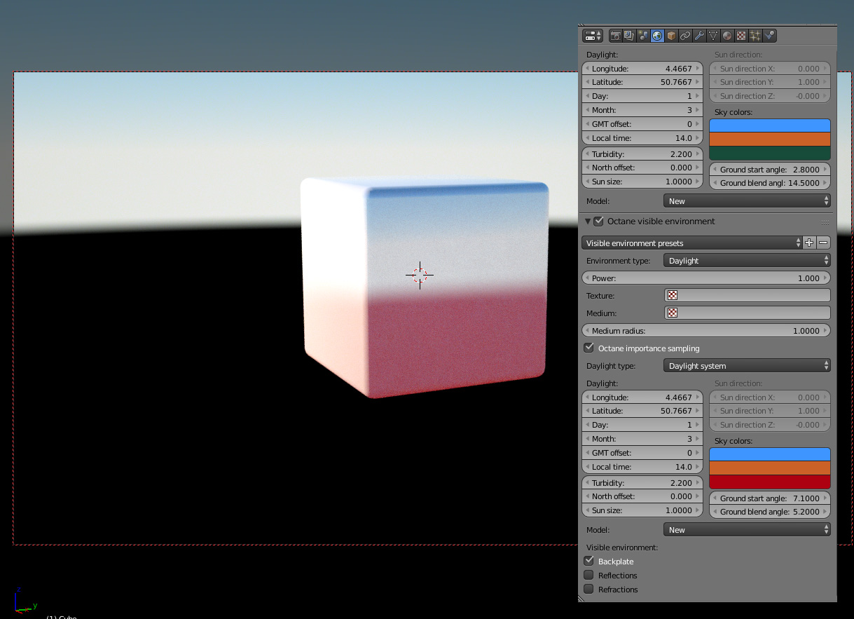

When enabling the Octane visible environment >> the base color of the ground is not working and gives a black color in viewport and render. The right base color is only present in reflections as seen in attachment image. Also: When using hdri image as main environment and enabling the visible environment with reflections also checked >> it shows the base ground color in grey.
Visible Environment Ground Base color not working
