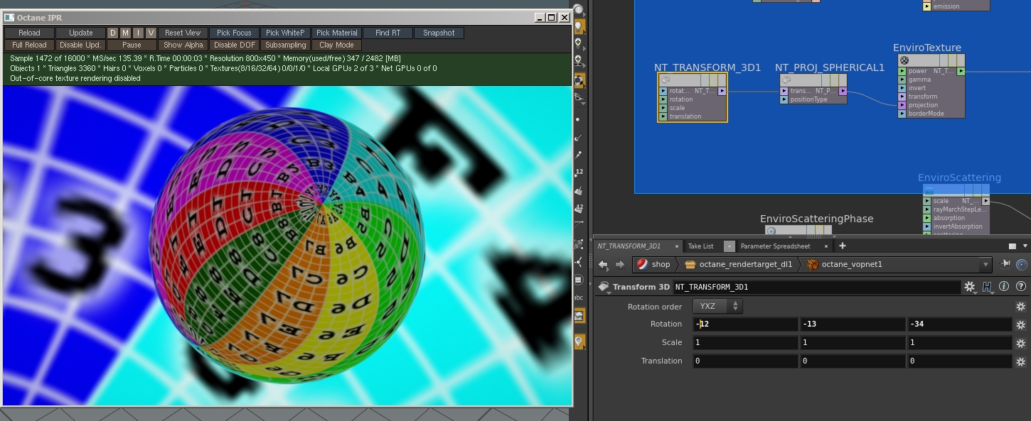

So I've done the same and got it to work by going inside the target node and attaching a spherical projection node to EnviroTexture and another transform3d to the projection and it works nicely. I think it should be implemented in the rendertarget asset and exposed to the user. It's a much more desirable behavior for tweaking the environment.

Ah, Ok. So you are linking the transform_3d node to the spherical projection node, not to the texture node, right?
Using this workflow the environment transformation seems to work fine. I can modify the render target HDA to work with this node setup, at least as an option.
