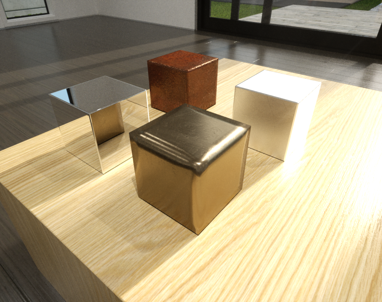

Hi Paul,
looks like it works pretty well as long as the edge radius value is small. Looking at the attached image, the table top and cubes to the left, right and rear have 2mm edges radius and look fine, the front cube has a 25mm edge radius and looks pretty wonky...

Hi Dan - yes, up to about 0.1 works well, but things got wonky after that.
Paul
