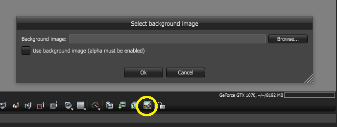

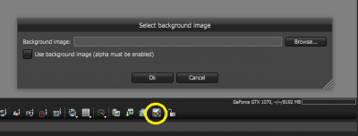

You can do that too in Standalone, however I could not find that documented, so it may need to be updated.
There's a button in the toolbar under your render viewport that lets you choose the background image, just make sure you enable alpha in your kernel settings.
