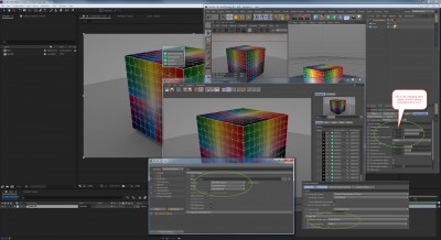

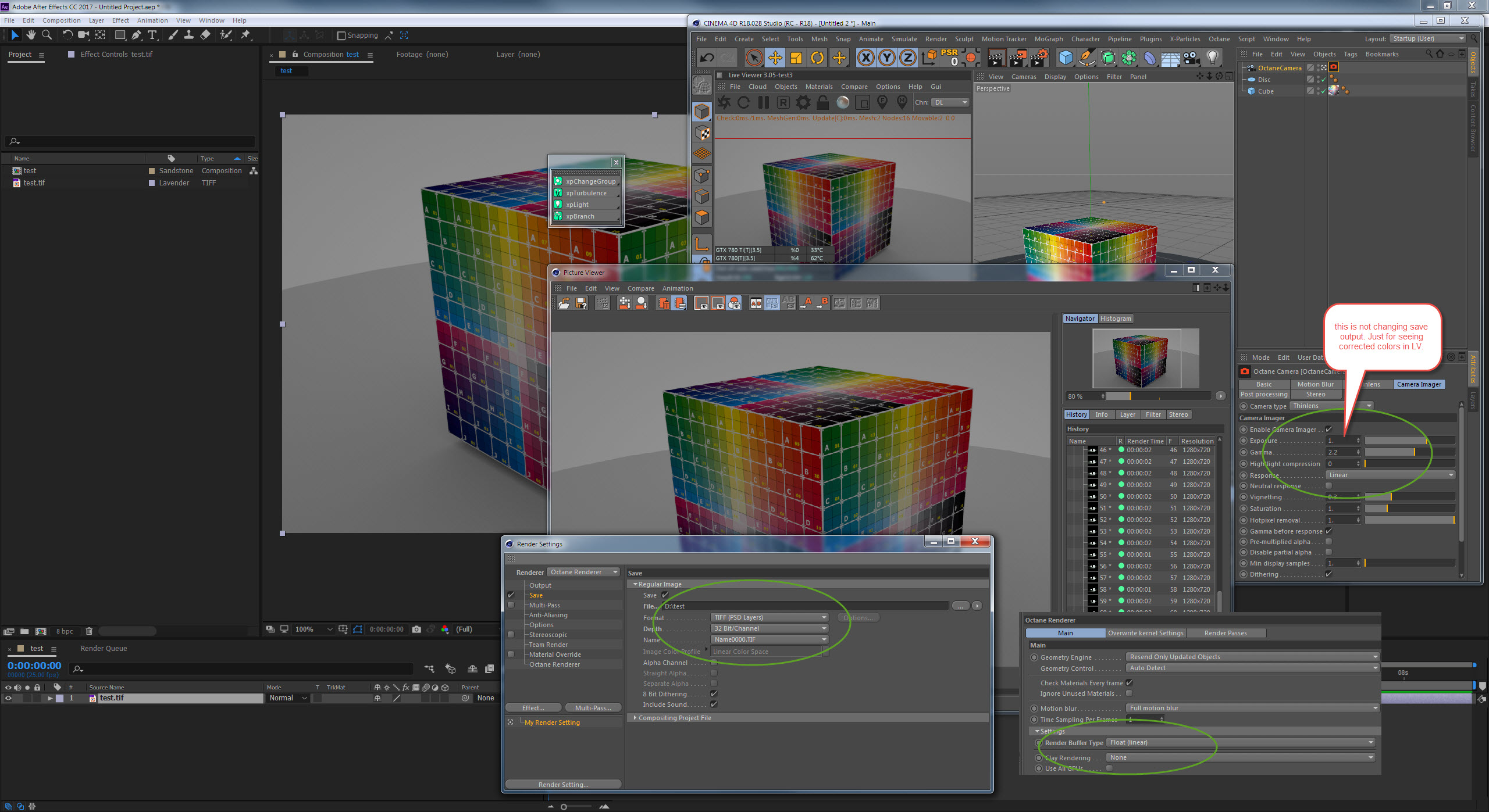

See image. Making gamma=2.2 and linear is just for monitoring purposes. It doesn't affects output if you select "Linear buffer" in render settings.cristiangiro wrote:Hi Aoktar,

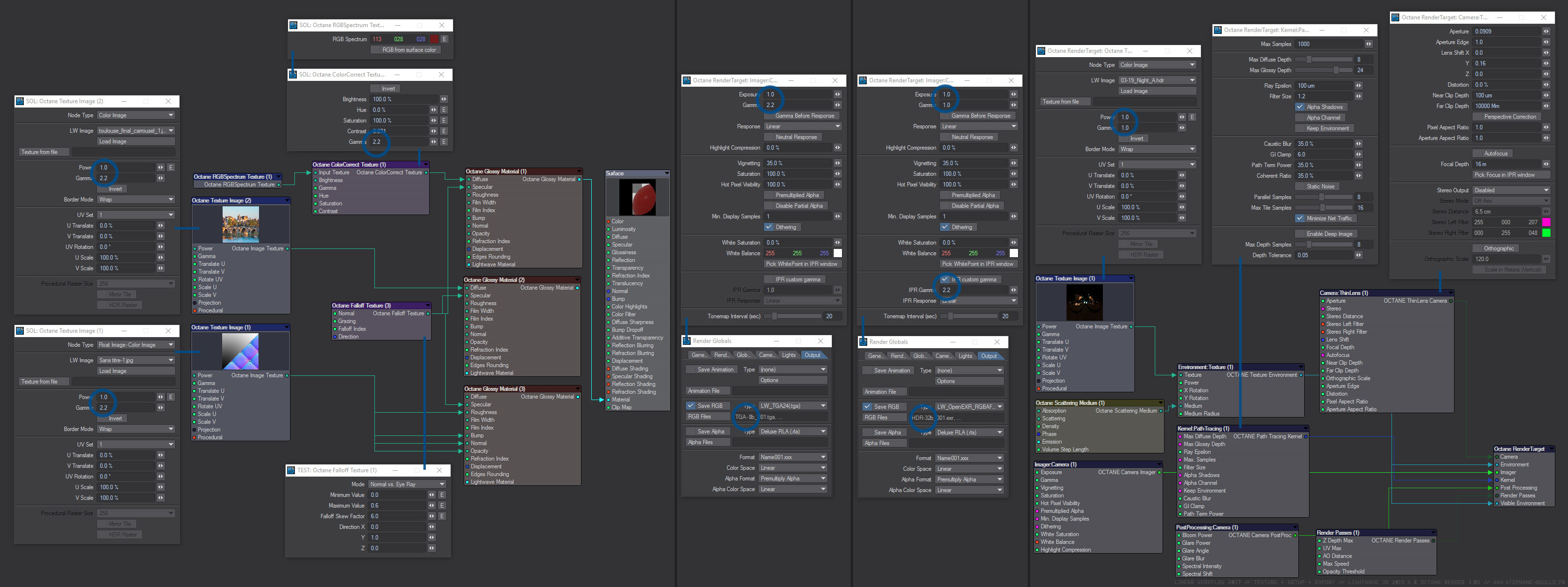

Hi !
I hope you have solved your issue,
This schematic view explain how get linear workflow on Lightwave,
>>> http://www.stephane-agullo.fr/files/LIN ... W_2017.jpg
If it can help !
Bye.
