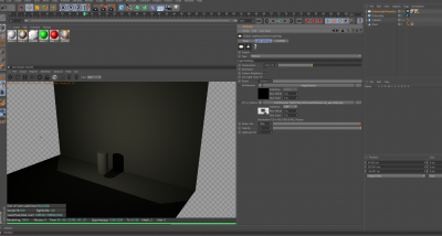

I'm trying to create a projector to project an image over a bunch of cubes. I searched for it and found a thread on here but for some reason I cant get even get the project file that aoktar attached to work, its just a light no image projected.
Apparently all you do is load an image into a material and add it to a light and it will project but when I do this nothing projects its just a normal light.

Am I missing something here? I have Octane 3 but I don't know what I'm doing wrong. Thanks in advance.

Thank you for the quick reply. I'm looking in the manual and don't see a subject for scenes or light-projection even copied the link you gave me into the search and web browser...sorry I'm a messaoktar wrote:Check manual files for c4doctane_300\manual\html\scenes\light-projection.c4d
Sorry for not being clear. I meant that offline manual archive. See directory from this archive: https://render.otoy.com/plugindownloads ... ual-V3.zip

Thanks, but yes that's the same scene from this last thread viewtopic.php?f=30&t=42275&start=0
it isn't working for me nothing is projected on the wall its just a light.
Because image is missing.

Thank you, I also figured out last night if you load a image in Distribution as a image texture it will project.
