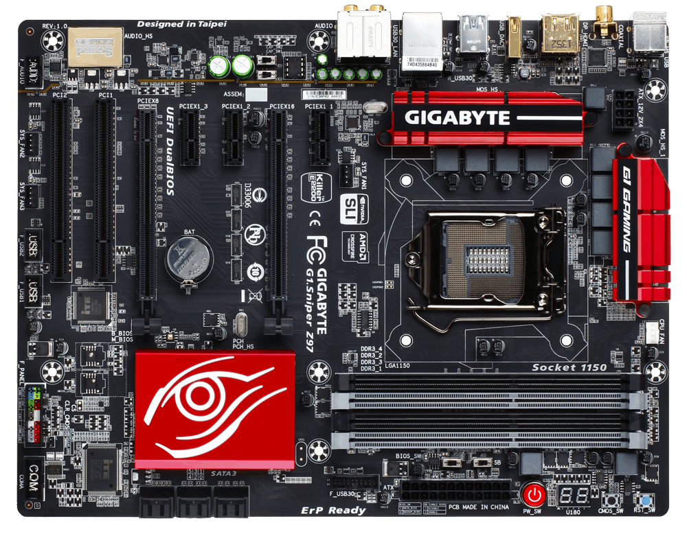

My motherboard is a Gigabyte G1.Sniper Z97, and I have a 750W Corsair CX750M power supply.
My motherboard: http://www.gigabyte.com/fileupload/prod ... 29_big.png
Unfortunately, I don't believe my motherboard supports 3-way SLI, which (I think) is what I would need. I suppose I could only keep one of the cards, but that seems like a waste.
Any notions?
Thanks again!
Any notions?
Thanks again!

Alien expansion unit would not work, as it has proprietary connection as far as I remember & it's designed for their laptops, not for desktop. if You want to expand You current system, that's different story..
as for Your hardware, Your board is quite limited & if You would google up information about Your PSU it's flawed as well ( in some condition, when temperature get's higher it's not entirely the most stable unit =)
if I would have You rig, I would change motherboard & get better PSU =) in this way You should be able to upgrade up to 4 cards =)
