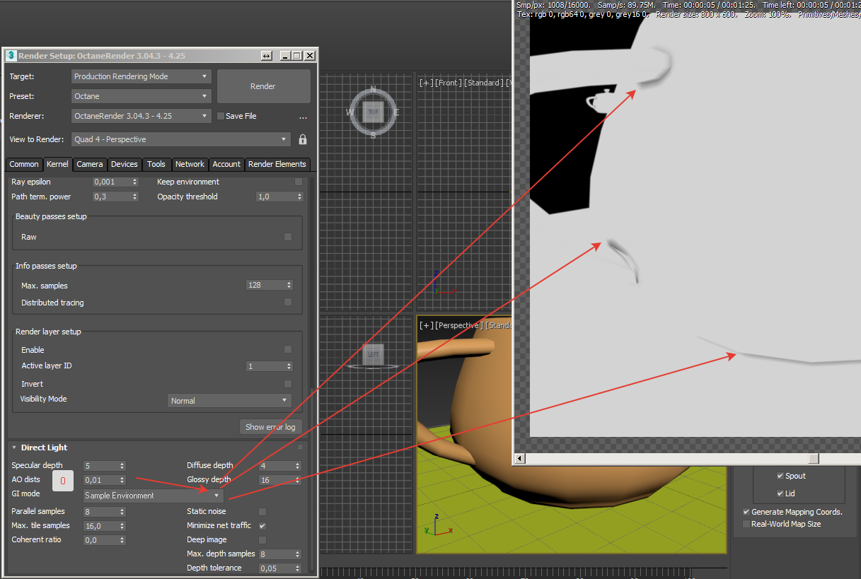

sorry I work at 4, 25 -- can't test at 4.26
what that position fails and it stops working post the scene
maybe this picture will help you
..... I think I understand .... somewhere should be a button to tweak the setting a Z-depth but I know two versions is in the info channel and in the render elements ... but I can't change the depth to make it more advanced
I really want the Z-depth max-what do I measure ? let's be tied to the values of scene - mm - cm - m - - - and then some incomprehensible value than to measure I do not understand

please note we have two different filter but have the same name

I want to remind that there is still no way to remove the AO to zero . alternatively, you can use the filter Diffuse filter but for a simple project values you used to be able to remove AO using GI mode Sammple Environment - now this feature does not work
in this environment, I simulate AO - Dirt on the material objects
