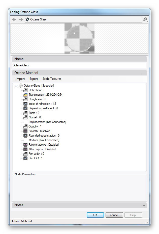

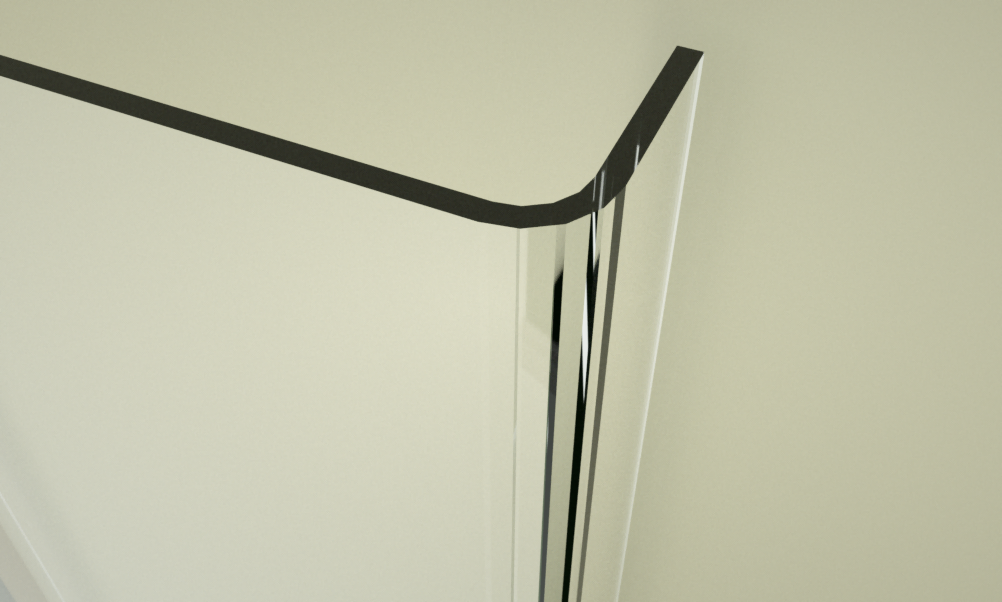

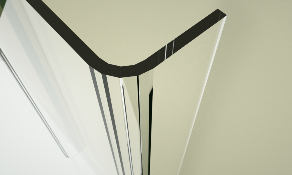

Having an issue with the Octane glass material, rendering with Path tracing using largely default settings.
It looks like the mesh is too lower res but upping this only divides the issue.
Any input / tips appreciated.

I added tiny bit of roughness like 0.01 might fix it and speculate to 16

If those are geometry faces inside the glass you may want to increase your specular depth in your kernel settings.

Also try reducing the Kernel->Ray Epsilon.
