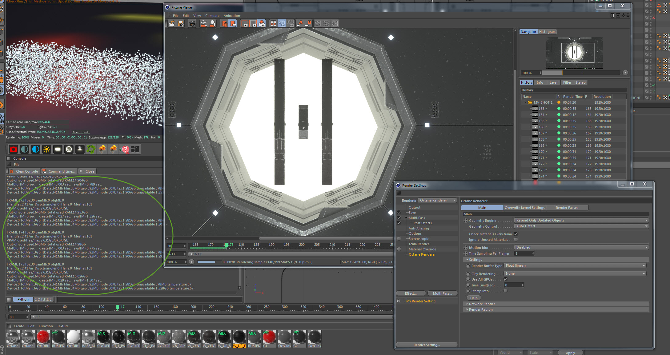

I have an object that's being manipulated with a Spline Wrap + MoSpline + Turbulence + Wind
When I render out to video. Octane only renders out 1 frame.
The scene is using only Octane materials and does animate in Live Viewer.
The object is about 2m polygons, but when I use the polygon reducer tool the scene renders out fine.
Is there any way to create this motion without losing the quality of the model?
Let me know if you need the file and how I should send it.
Thanks!
Posts: 16068
Location: Türkiye
what do you see in Octane Log? Errors?
I did a quick run for render output and it's working well. Could you been on limits of gpus? I see that textures takes much vram and it can give errors with low VRAM if you don't have out-of-core activated.
