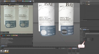

mitchino wrote:Right, I've made a new poly object from the front surface of my label. I've assigned an octane material to it that uses my label image in the diffuse channel. I've gone into body paint and adjusted the UV map so the texture fits properly. So that texture is applied to the label using UVW mapping.
I then duplicate that material and set it to a red colour and use the same image map in the opacity channel, selecting a different layer to use as the mask.
I then apply that material to the label, using the exact same UVW mapping, and it doesn't line up.
Why the hell is this so HARD?

can you take a look this file and explain to me why the stacked textures don't align?
Ailsa.zip
(2.51 MiB) Downloaded 136 times
Posts: 16068
Location: Türkiye
It seems like a bug on my side. Use this workaround until it's fixed.
mitchino
Posts: 455
Joined: Thu Jul 14, 2016 4:49 pm
Yes, that sorts it - glad to know it's a bug - I was beginning to go mad!
