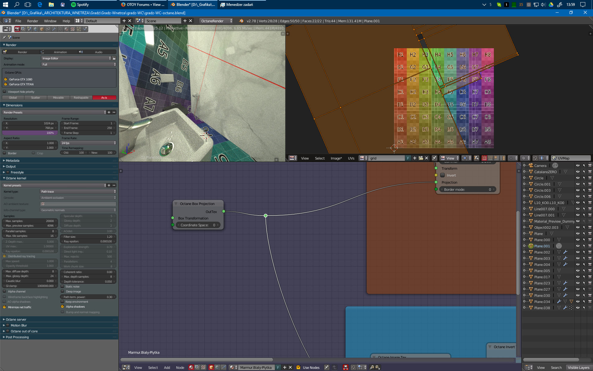

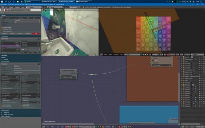

I found a Bug in Blender Octane Edition 2.78:
Reroute point disables working of any Projection connected to it ( i.e Box projection that is connected via reroute point Octane uses UV by default )
When reroute point is not used and Projection is attached directly to Octane Image TexNode then everything works fine and dandy !
When Reroute point is used - Projection does not work:
When Projection is connected directly then works OK:
