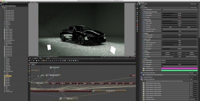

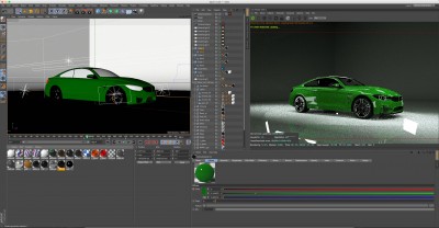

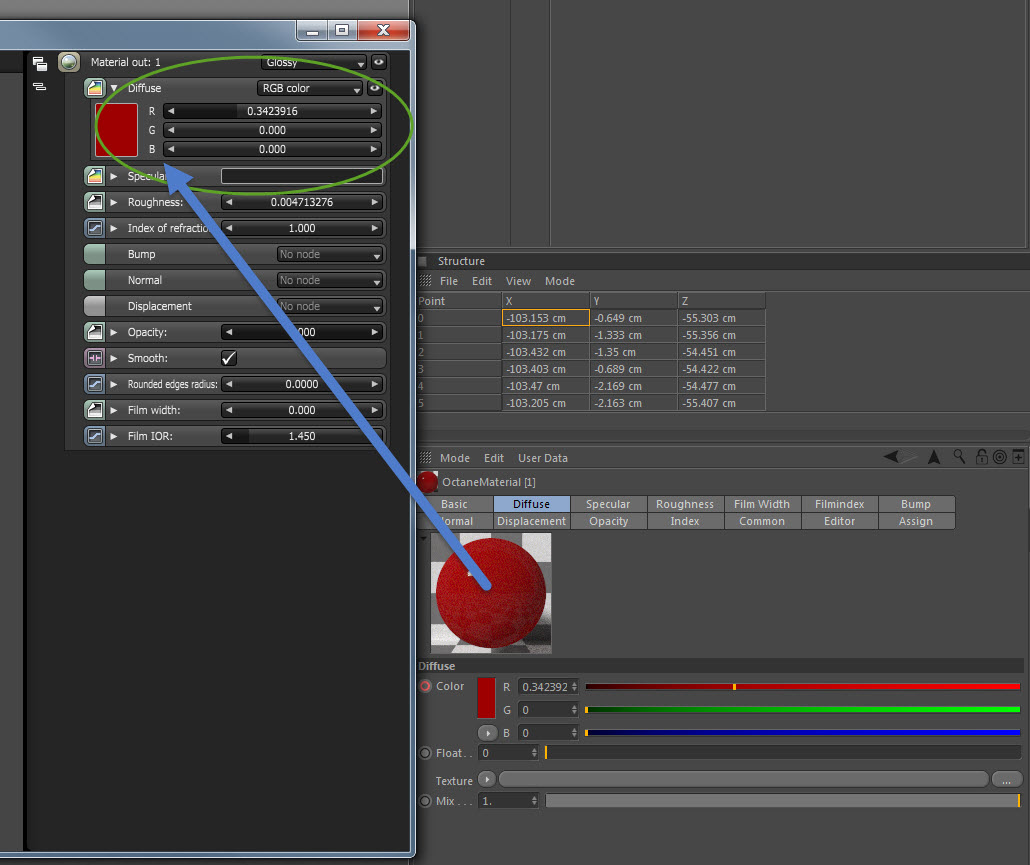

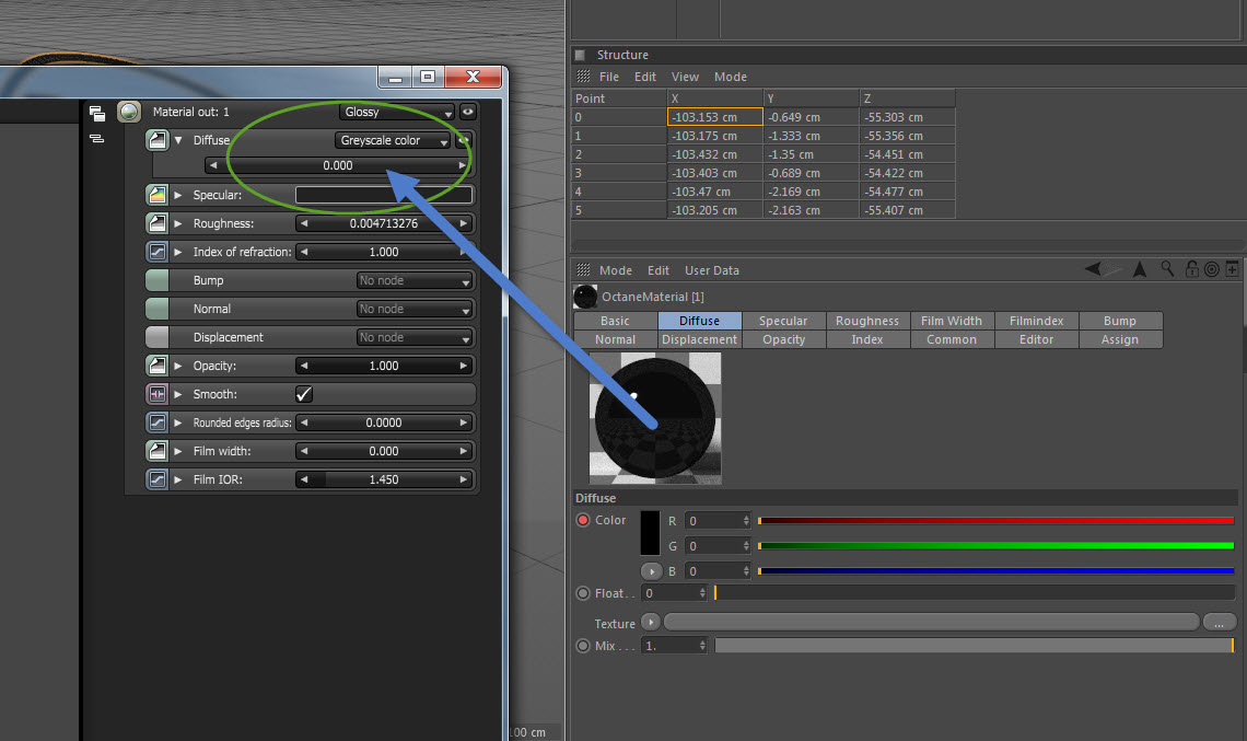

Thanks for scene! It's unexpected case and i'm not sure that's understandable by users. But i'll try to explain why this happened.
ORBX exporter expects a continuity for nodes of materials to able to save animation data. See first image. We have "float texture node" for black. In second we now have "rbg Spectrum node" for Red. And this caused a break on exported node.
Plugin don't care this for Interactive mode in LV or animation rendering. But exporter is sensitive to availability of nodes. I hope this part makes some sense.

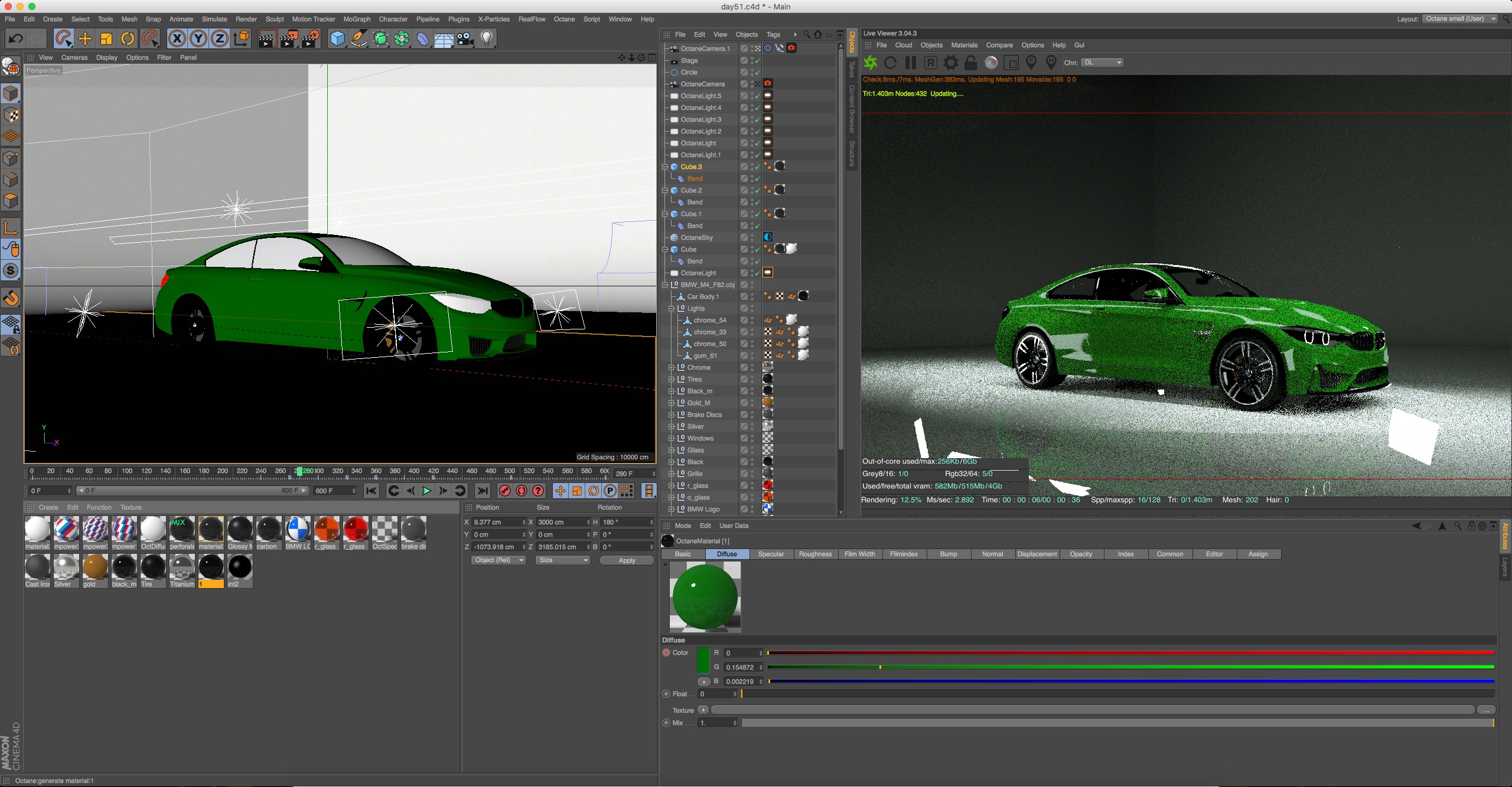

Now solution:
Create rgb spectrum in diffuse slot. And animate it. So exporter will write all data without destroying it. Obviously this is a case to be handled differently by plugin for export mode. But will require a lot changes.
