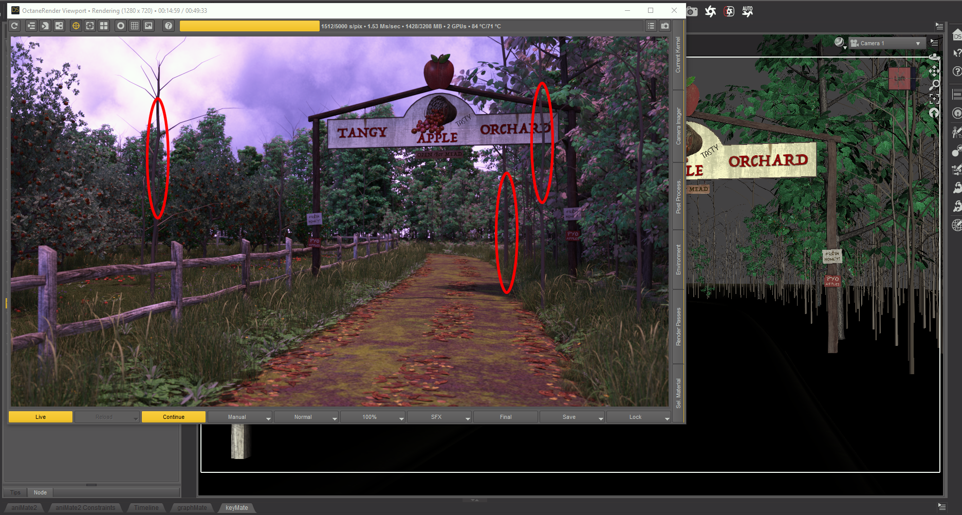

face_off wrote:Below is a (highly) experimental build which attempts to provide support for grouped instances.
It still has some issues with placement (see attached pic), but considering that previously this scene rendered with a bare field and a couple of trees this is a big step forward.
face_off
Posts: 15759
Location: Adelaide, Australia
Looking good. At a guess, there is something odd with the transform of that tree instance group. Perhaps is has nested instances? You will need to do some digging to isolate the specific instance that is not right and see if there is something obvious that might be causing it.

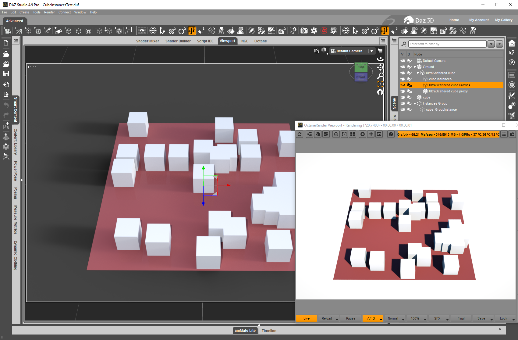

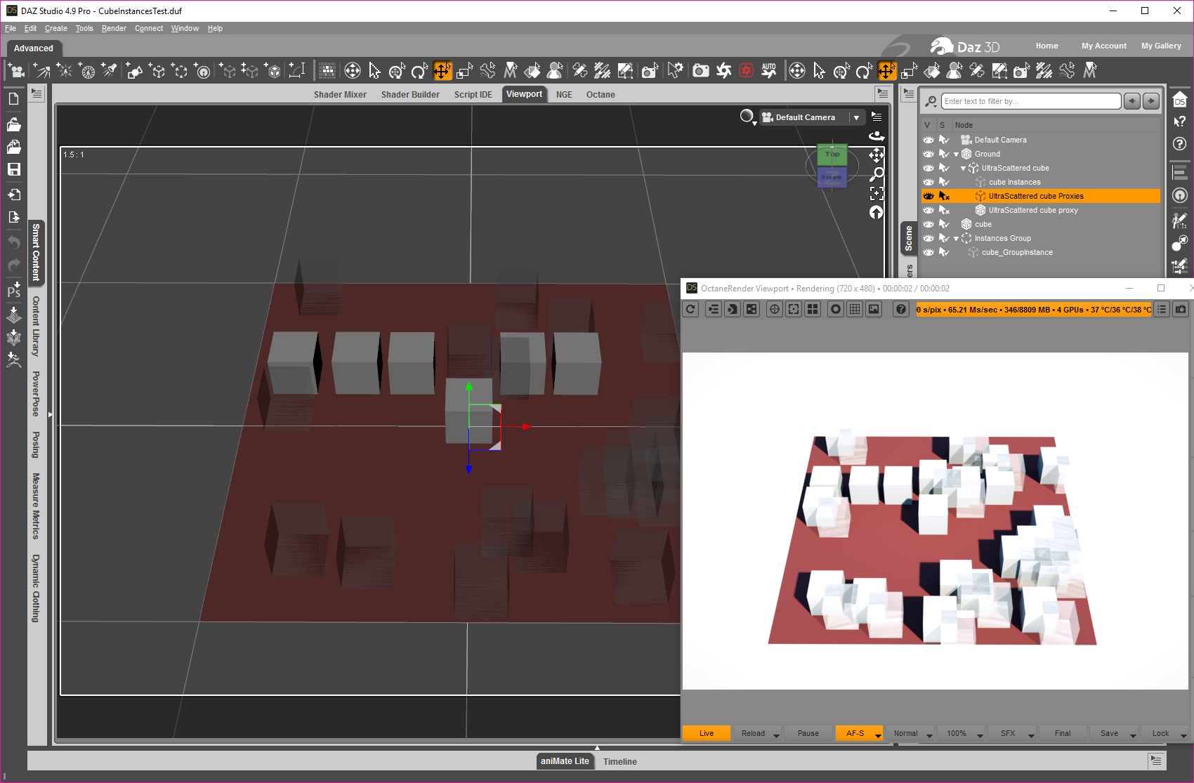

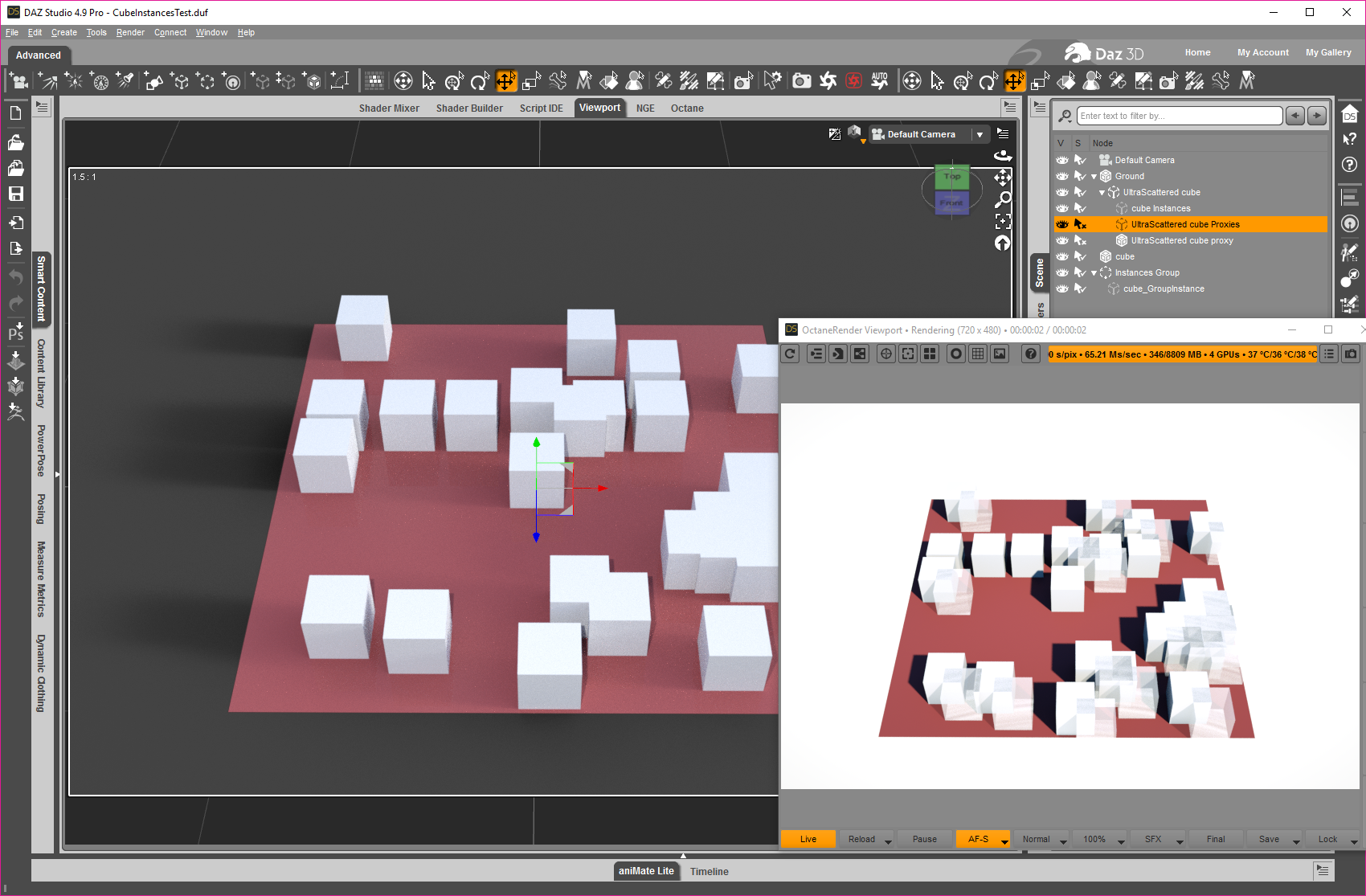

Have tested and have an update for you. It works perfectly with any DzInstanceGroupNode groups created but there is an additional property you need to check for before you create the scatter nodes in the Octane Plugin. For each DzInstanceGroupNode node you find, you need to call getPreviewControl(). That returns a DzBoolProperty type and you can call getBoolValue() to get the true/false value. If the getPreviewControl() returns true, do not use that DzInstanceGroupNode node to create scatter nodes in Octane. Simply ignore it. This node is meant for Daz to display a low resource version of the instances on its Viewport. If the getPreviewControl() returns false it indicates that that node is for actual rendering and the Octane plugin should create the scatter nodes based on that. Currently I don't think the experimental plugin is taking that into account and as such is rendering twice the number of instances for scenes created with scripts like UltraScatter that add an additional proxy (low rerource) instances node meant only for preview in Daz Viewport.
//Sample script code
var PreviewControl = CurrentDazInstanceGroupNode.getPreviewControl();
var IsPreviewNode = PreviewControl.getBoolValue();
if(IsPreviewNode == true)
continue; // Ignore this
else
CreateOctaneScatterNodes(CurrentDazInstanceGroupNode);//Create the scatter nodes based on this
In the below screenshot from the CubeinstancesTest.duf I sent you in the other post, if you look at the Daz Viewport, the dark semitransparent cubes are low resource preview instances in the UltraScattered cube proxies node. That node will return true for getPreviewControl(). In the Octane Viewport, you can see it is rendering the actual instances contained in the cube Instances group (solid White) and also the preview node UltraScattered cube proxies (semi transparent cubes). Hence the extra instance being rendered in Octane plugin.
Preview instance and actual instances being rendered in Octane Viewport
Switching to IRAY render you can see that IRAY is ignoring the preview node, Octane plugin is not.
IRAY ignoring PreviewNodes, Octane is not
Finally if I manually turn off the UltraScattered cube proxies visibility, both IRAY and Octane Viewports match.
Manually turning off the Preview node
So like I mentioned above the Octane plugin need to check the getPreviewControl() for each of the DzInstanceGroupNode nodes it finds and it that returns true, ignore that group node.

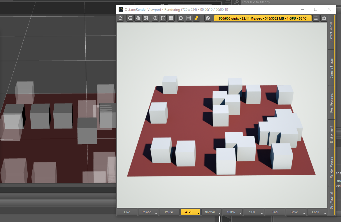

This approach is not working correctly - you can see the original 6 cubes from your previous scene are not rendering.
Paul
face_off
Posts: 15759
Actually - it's the cubes in the instance group attached to the ground which are not rendering. I will investigate further.
