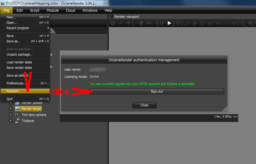

Actually some of our render computer are locked on 2.23 and v3... So half of our render farm does'nt find the licence.
We have to do something to fix that. Can't we lock octane v3 with the offline activation?

So if I want finish my v2 rendering, I have to desactivate my 16 v3 licences....
- paride4331
- Posts: 3985
Hi pump_studio,
Yes it's correct. Precisely to avoid this issue in the future, the Octane V3 license is floating now.
Regards
Paride
Regards
Paride
