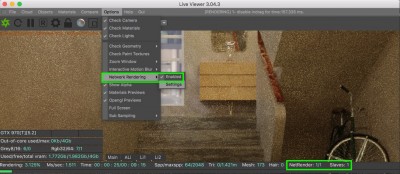

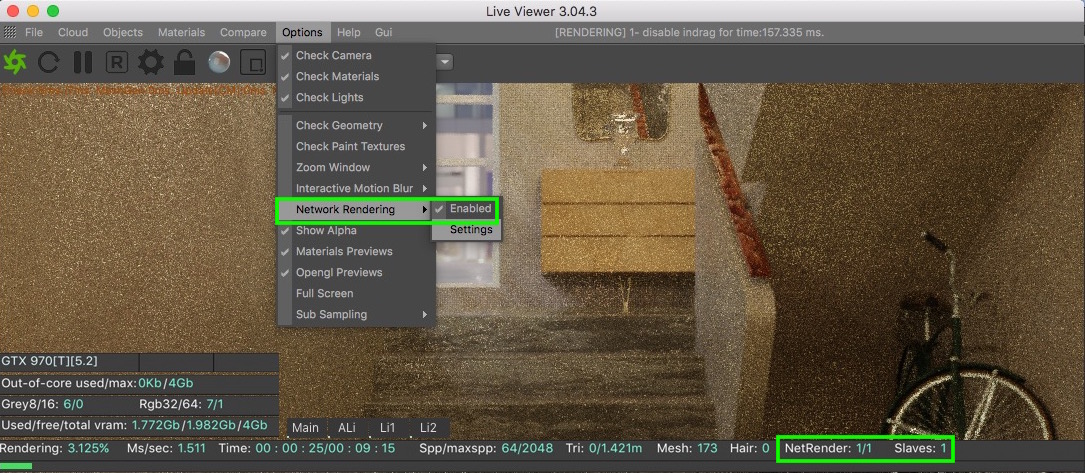

Posts: 10468
Yes correct, and you can use it also in Live Viewer:

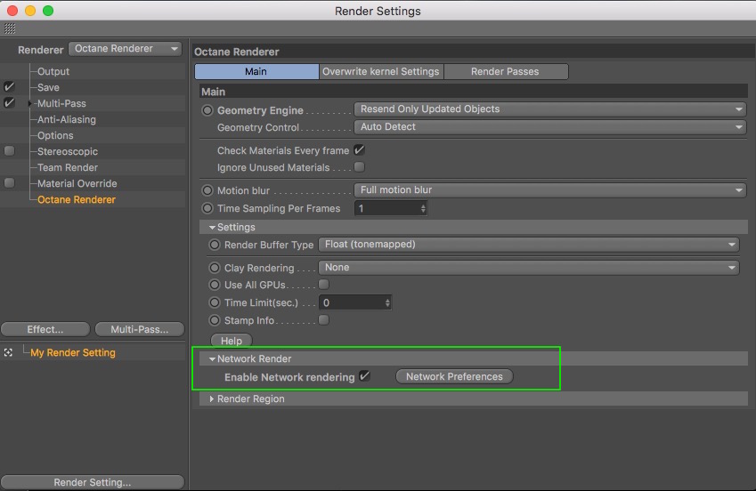

Or in Picture viewer:
If enabled for the Picture Viewer, it works also with Render Queue or Team Render.
You can have a max of 20 GPUs per single Master, considering both the GPUs in the Master and in the Slaves.
