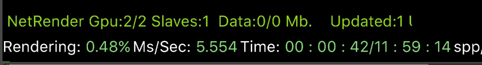

Bonus bug: There's some sort of display problem with the Network Slave stats, a word is truncated
