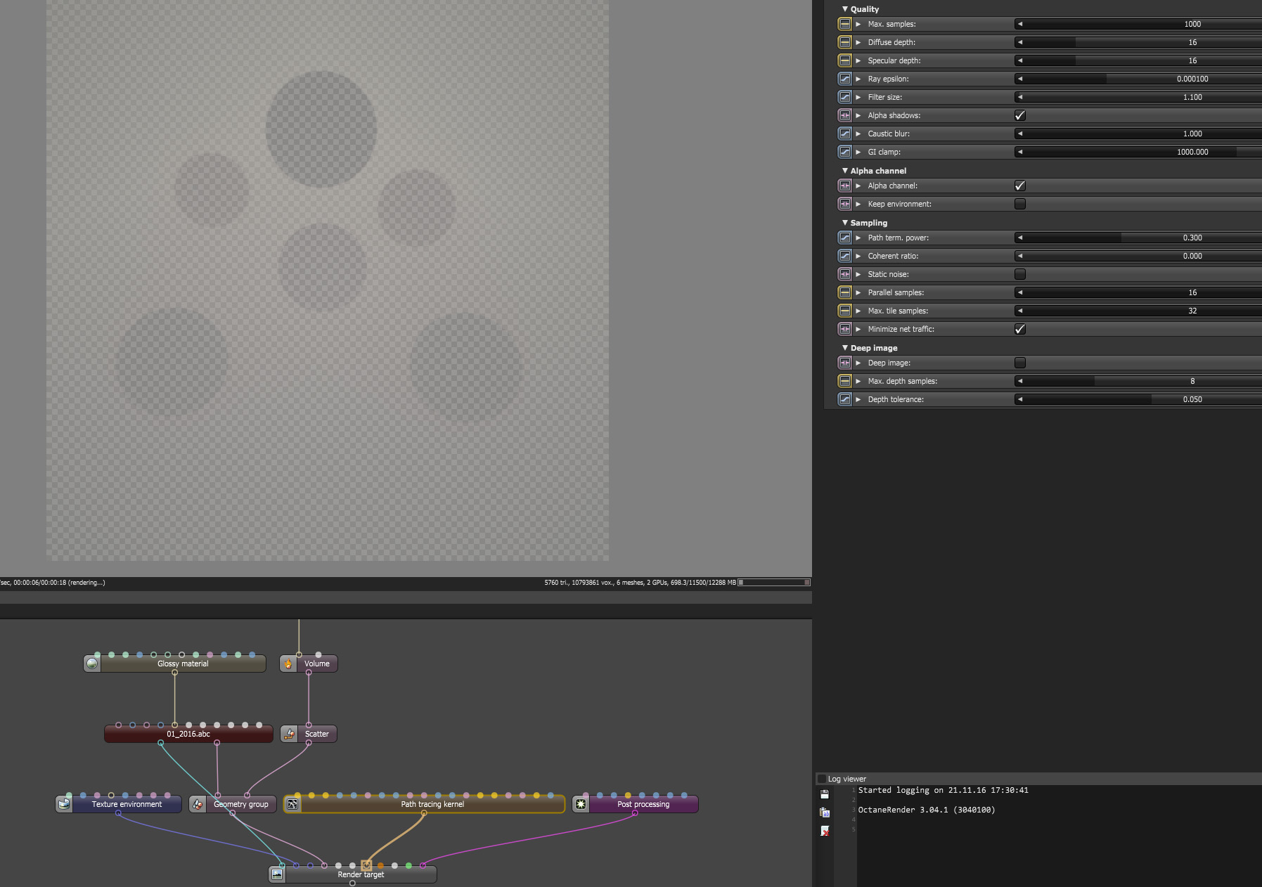

Alpha is wrong when scatter enable in daylight (saving in png)

Hi thekwen,
at the moment we can not have a scatter layer environment.
You may obtain scatter layer using .vdb, but this feature is not active yet in Octane 3dsMax plugin, because it is a 3.04 feature.
I will ask developers to enable it asap.
You could also use the old method of a cube with scatter, but you could have only a multipass layers.
Attached a layer scatter workflow with .vdb (3dsMax) screenshot.
Allegato anche il outcome in OctaneSA.
Regards
Paride
