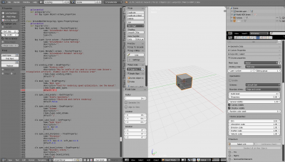

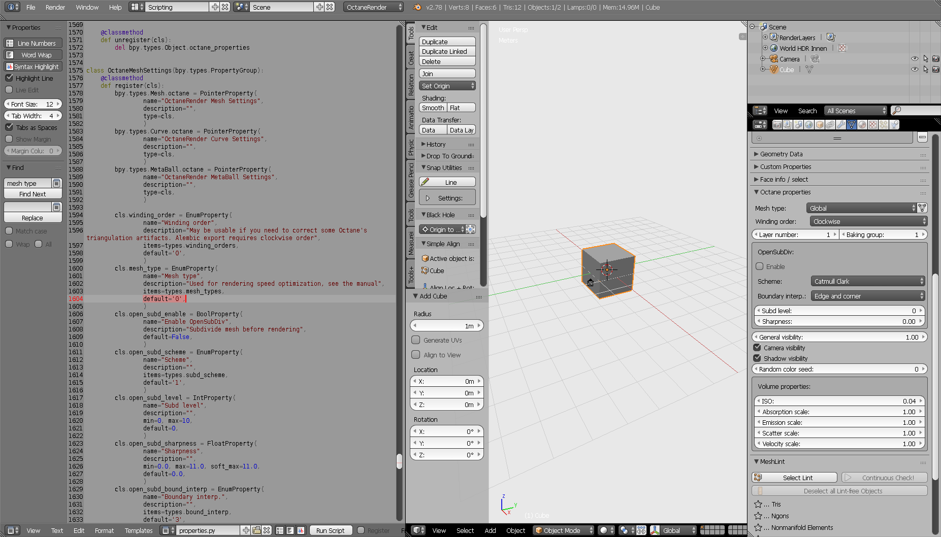

until you can change the properties.py script in the addon folder octane according to the picture below

OK, thanks for clearing that up. I was focused on rendering speed and had to manually set things back at 'global' to increase speed. It all depends on what kind of scene your creating off course and personnally I mostly do stills. I've now edited the properties.py as "aufwind" suggested and it fixed it for me. Thanks for that tip aufwind!
