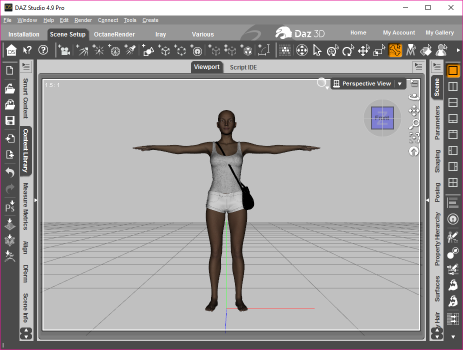

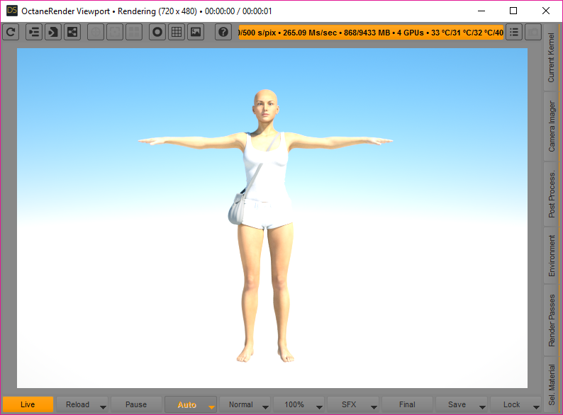

Another issue. Some props and accessories load in the wrong way in Octane Viewport. Have had this in all versions of the 3.x plugin.
In DAZ Viewport the bag is hung from the right shoulder and is at the left side. This is the correct orientation. But in the Octane window it appears in the reverse way.
DAZ Viewport - Correct
Octane Viewport - Wrong
Can you please take a look at this ? I am not sure if I save the scene can you read it as you might not have the same props in your Content Library. The bag in the scene comes in 2 forms - one left to right (original) and one right to left (mirrored). Both load properly in the DAZ Viewport. But in the Octane Viewport both result in the left to right (original) orientation. It makes me believe whatever 'transpose' has been applied to the bag is being read by the DAZ Viewport correctly but not being read by the Octane Plugin correctly. Reloading / Rebuilding does not correct it.
