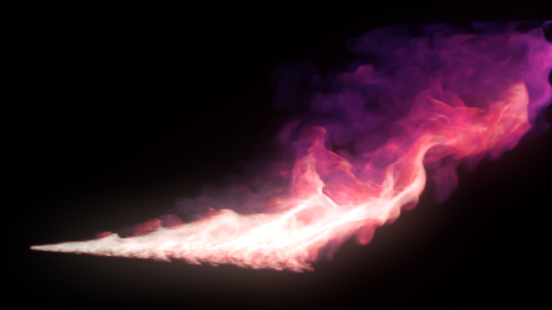

Starting to see some patterns with what channels will create smoke and what channels create a mono-colored emitter, I will update with findings.
here are 2 renders messing with it:
(1) I used the TFD flame thrower and change the color Ramp to have a rainbow smoke trail. I rendered in 2 sessions and changed bloom without thinking on the second half, which is why it changes midway
FlamerFlame.mp4
(3.56 MiB) Downloaded 1359 times
(2) I created a basic emitter, no tweaks really
Hot Head.mp4
(4.12 MiB) Downloaded 1348 times
Here is a Lavender flame
I am wondering the following things, will likely find out:
(1) Lower Voxel size = higher resolution? ie 0.1 is higher res than 0.5...
(2) What does it take to get a nice crisp high res voxel/volume/vdb/flame/V3-medium object/fluffaroo

It should not be so hard to see what's what after play a bit. Voxelsize is size of voxels. Same space will have much more voxels when voxelsize get smaller. Same logic as in pixels of images. Just one extra dimension on z.
There's a page in manual and some examples for tfd.
