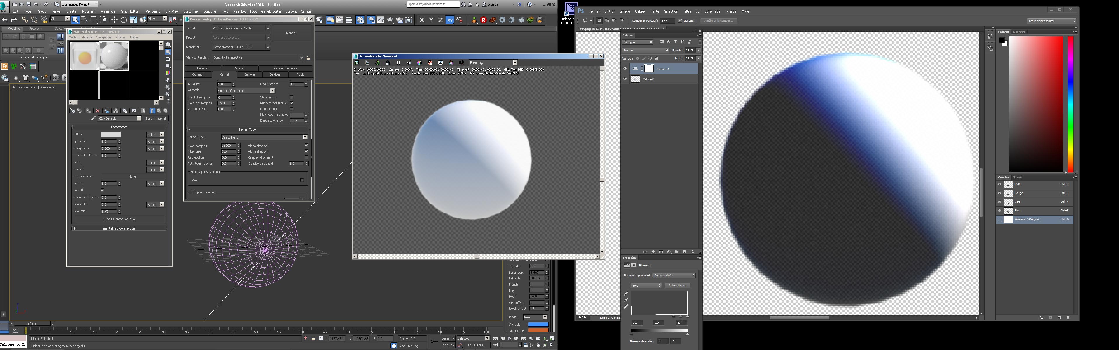

When using scattering in daylight and saving png with alpha, alpha is wrong.
Any idea on what i'm doing wrong ?
Image in attachment file ...

Hi thekwen,
around your question, the issue occurs not only in .png,
you could check it directly into the Octane 3dsMax viewer, activating alpha channel in Type kernel and increase scattering value.
My advice is to save beauty layer and then use the alpha channel as a mask.
I will try to know more about the issue.
Regards
Paride

If i do what you suggest i will have atmosphere only on object and not in environment ...
