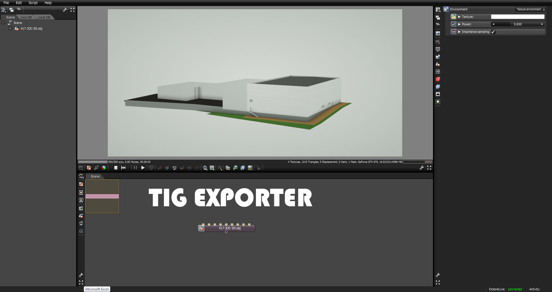

For the design of the nodegraph it is possible to add simplification options with possibility:
-to create or not the links of groups and components
-to create or not scatter links
- create only the display of the existing proxies
- to create or not layer
It requires display options, personally, I use the TIG plugin (a color sketchup = a material on Octane). I do not need groups and components.
Thank you
See as well Remark by SMICHA :https://render.otoy.com/forum/viewtopic.php?f=31&t=52187&p=261455&hilit=INTERFACES#p261504

In standalone you can use this super handy LUA script from Roeland, to hide nodes inside other nodes (basically go from your first screen to the second one) :
viewtopic.php?f=73&t=54108
Don't know if it's relevant for Sketchup nodegraph.
